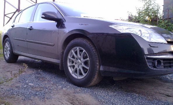

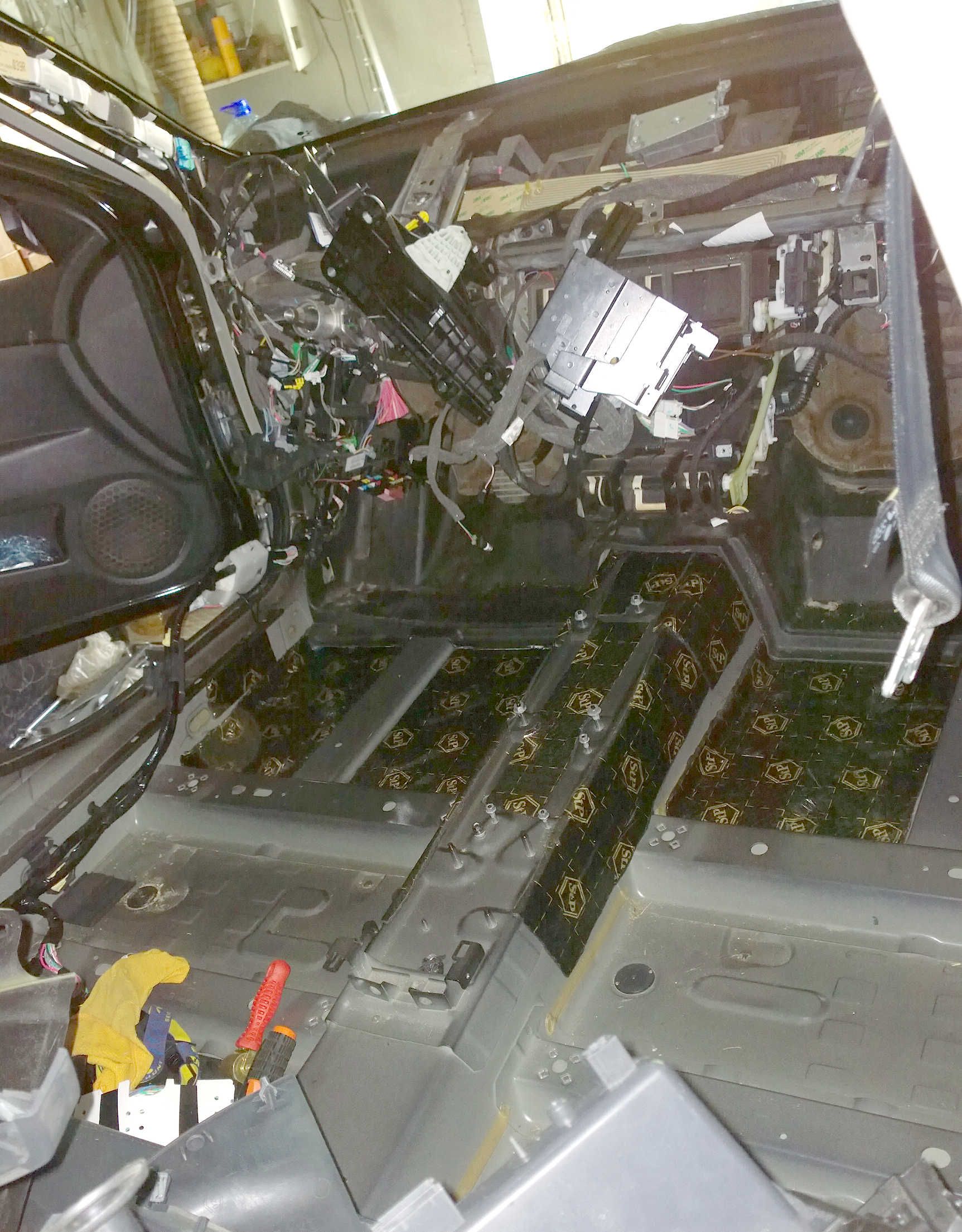

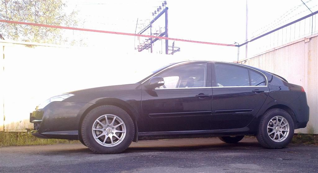

Hello!

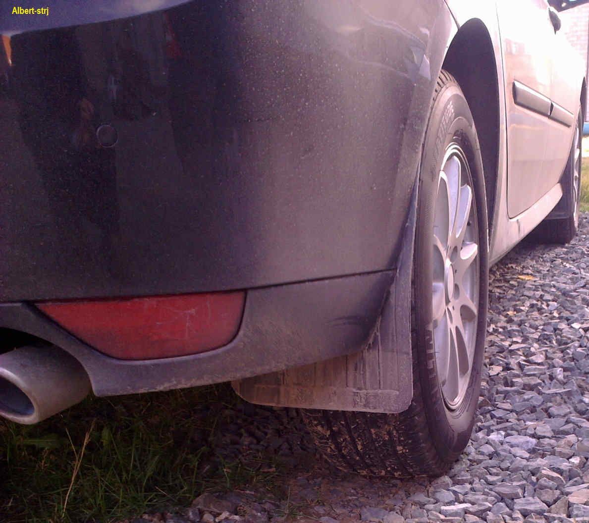

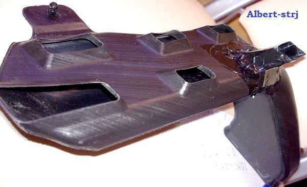

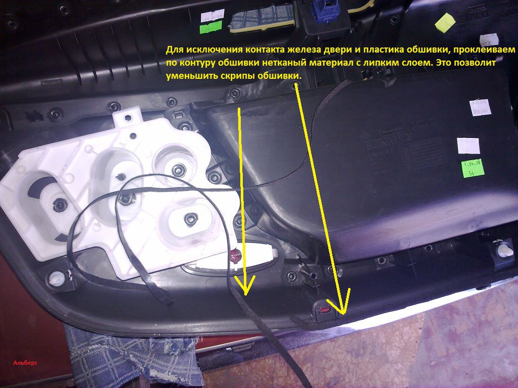

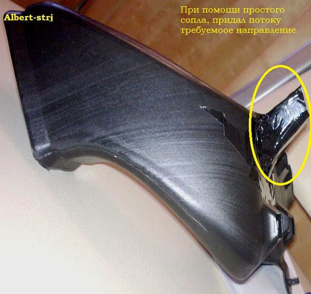

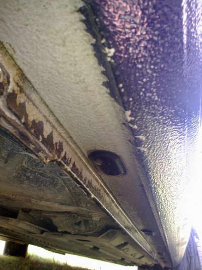

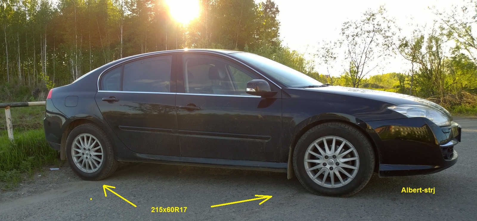

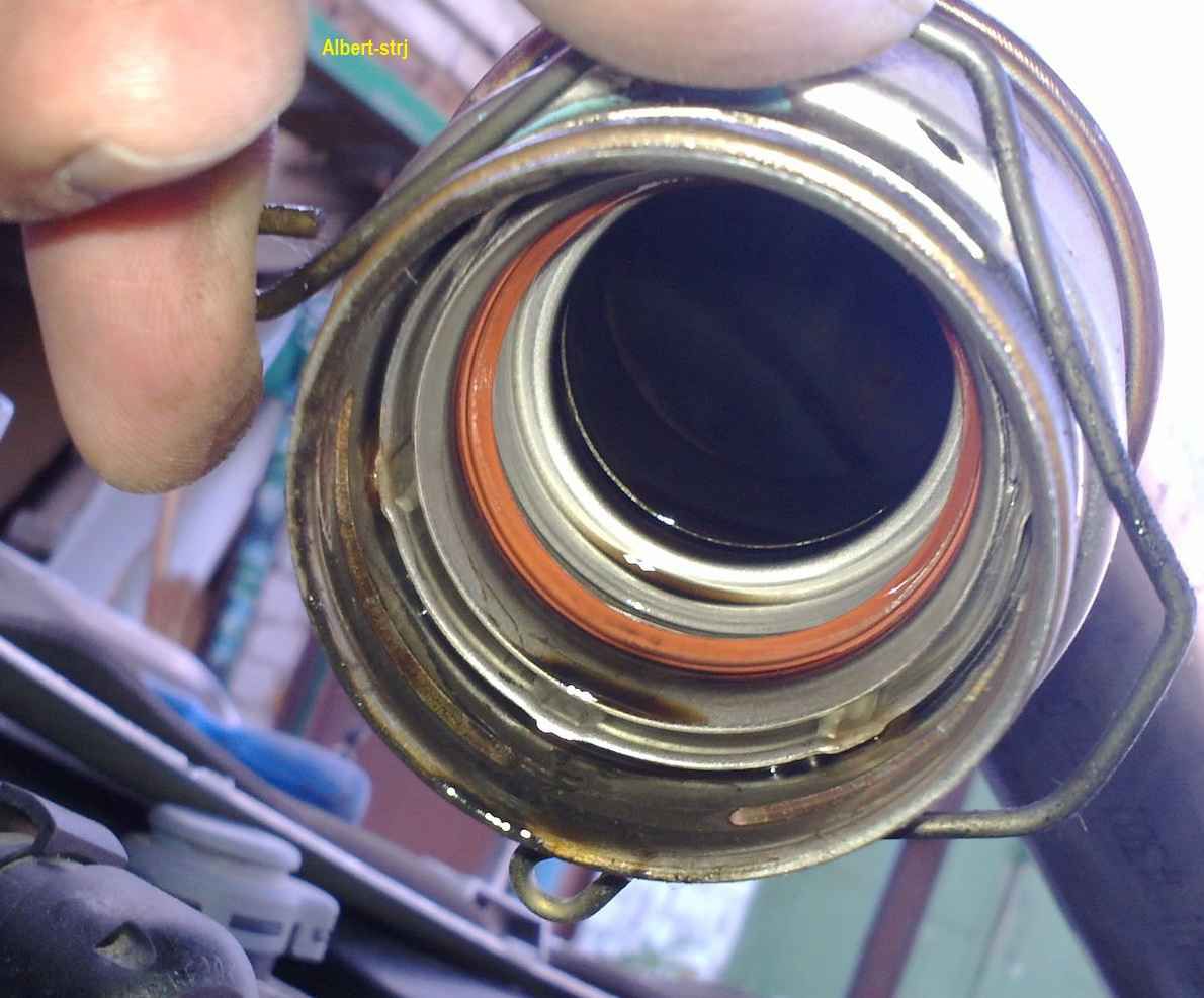

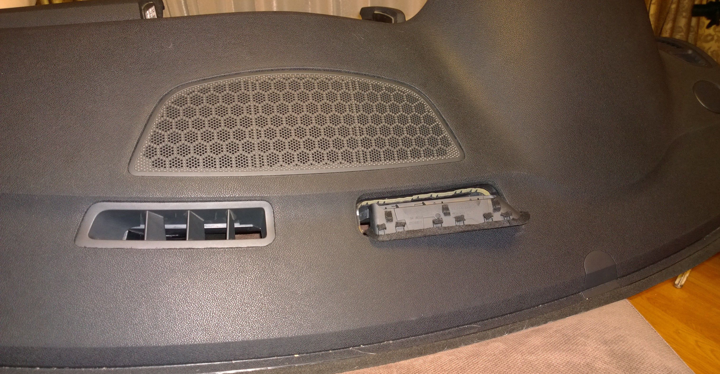

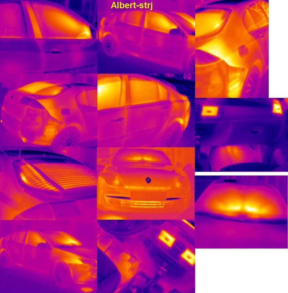

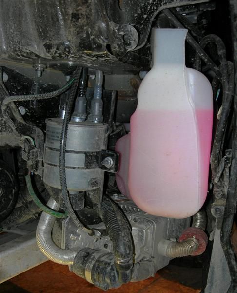

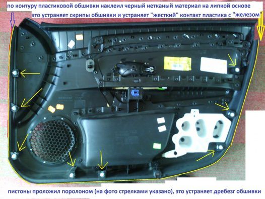

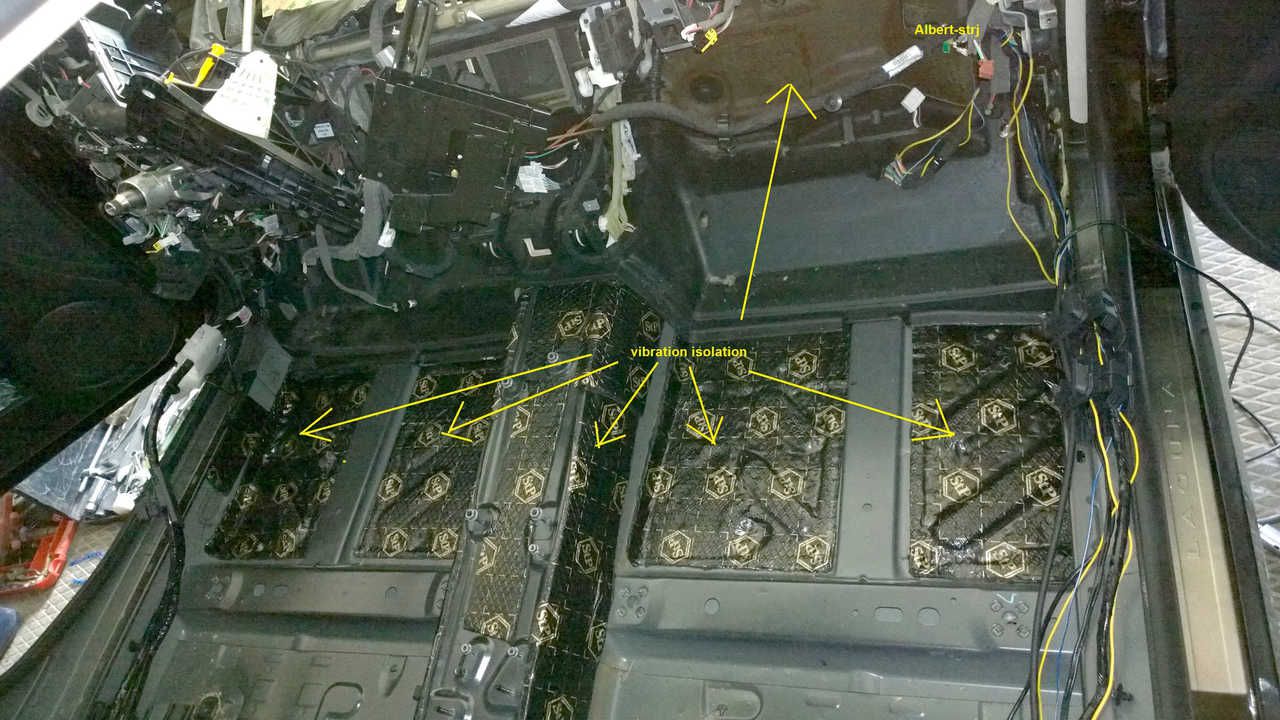

For comfortable operation, Renault Laguna 3 in the North of Russia:
Installed heated engine - Webasto ThermoTop 4kW. 2 times a year removed and charge the house battery car (agm 12V 80AH 800A if necessary, adding distilled water in a dried glass Mat).

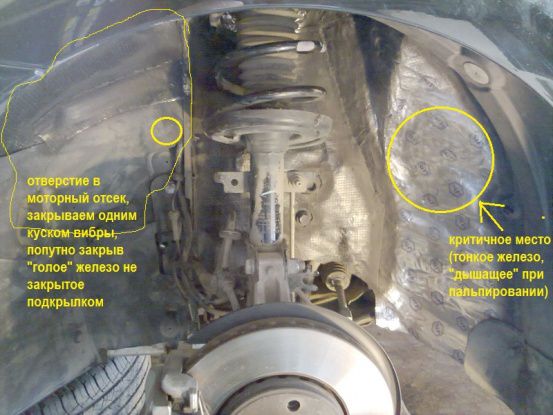

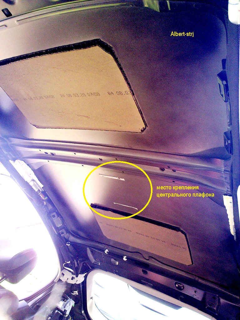

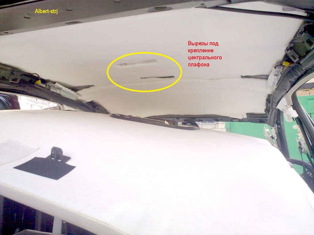

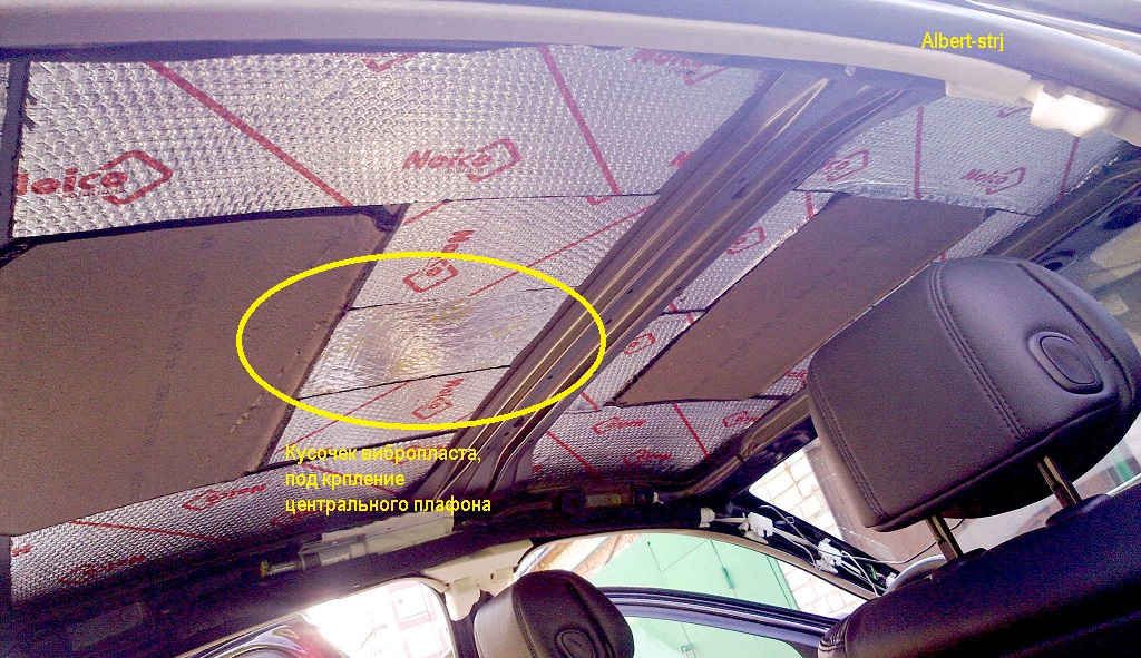

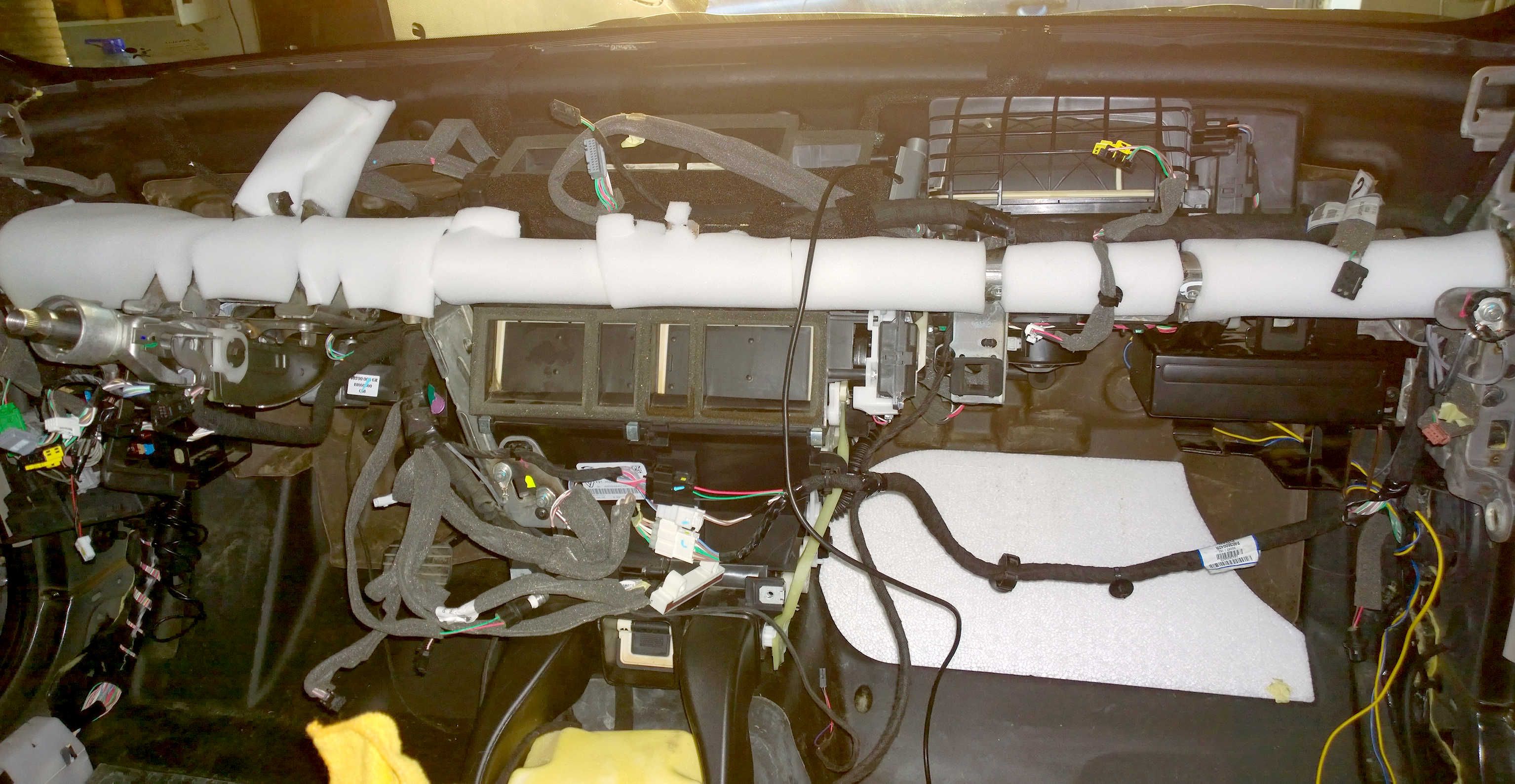

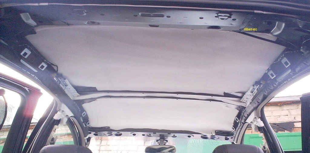

Disassembled the car and additional thermal insulation of the roof and doors. Replaced the side Windows on the double (triplex). Plan to install electric heaters in the back seat. Installed additional sealing hood and trunk closing gaps. Changed the configuration of the climate system of the car with the hot zone moderate zone. Installed additional nozzle to the duct of the driver (right foot was frozen).

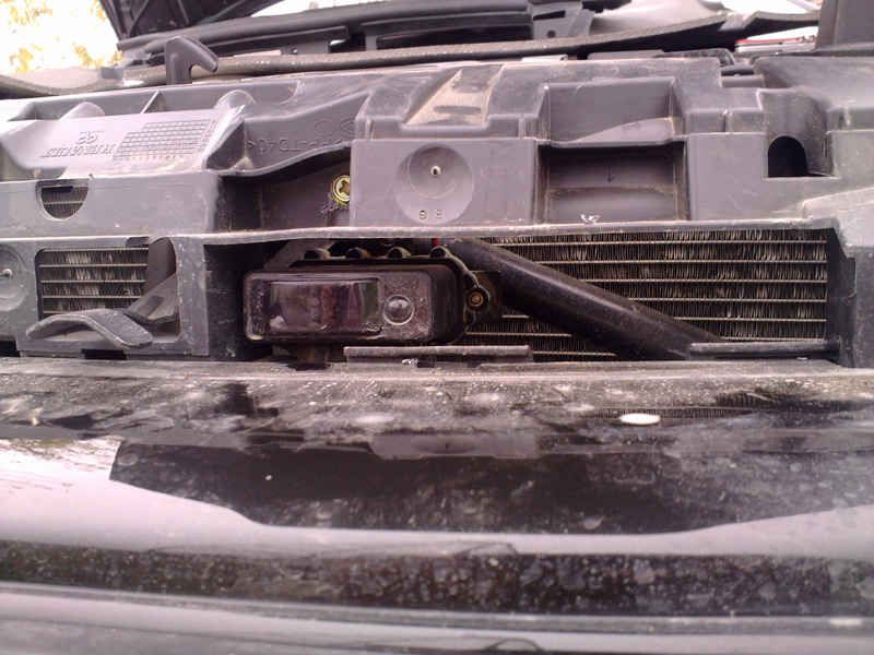

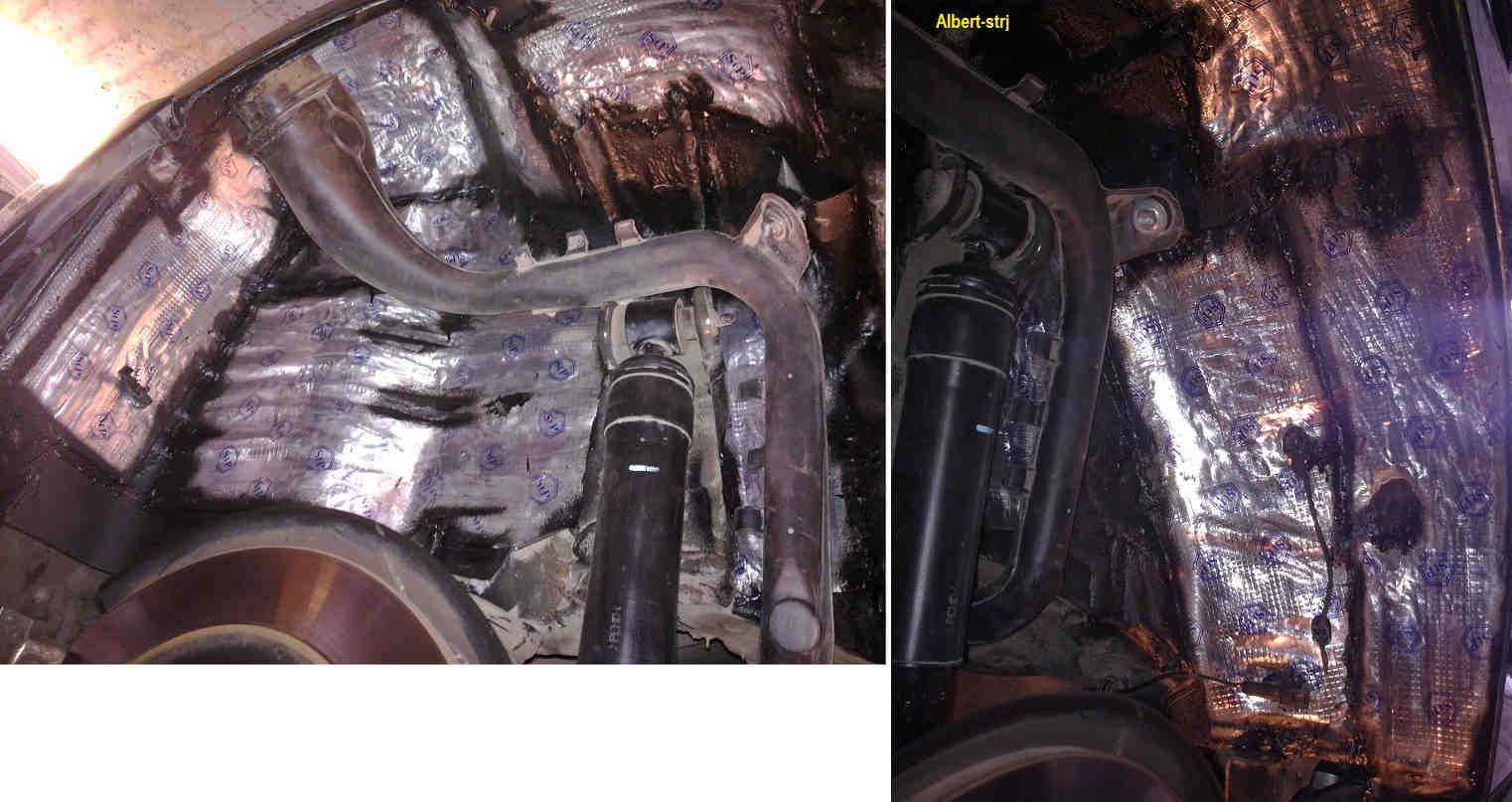

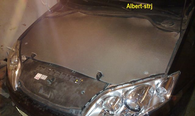

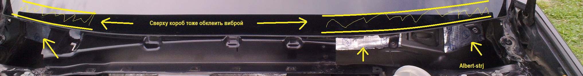

In winter, additionally insulated engine compartment (thermal insulation on the top and front of the radiator).

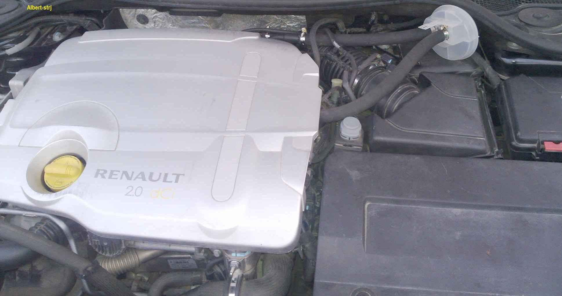

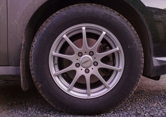

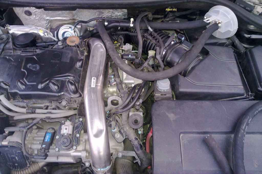

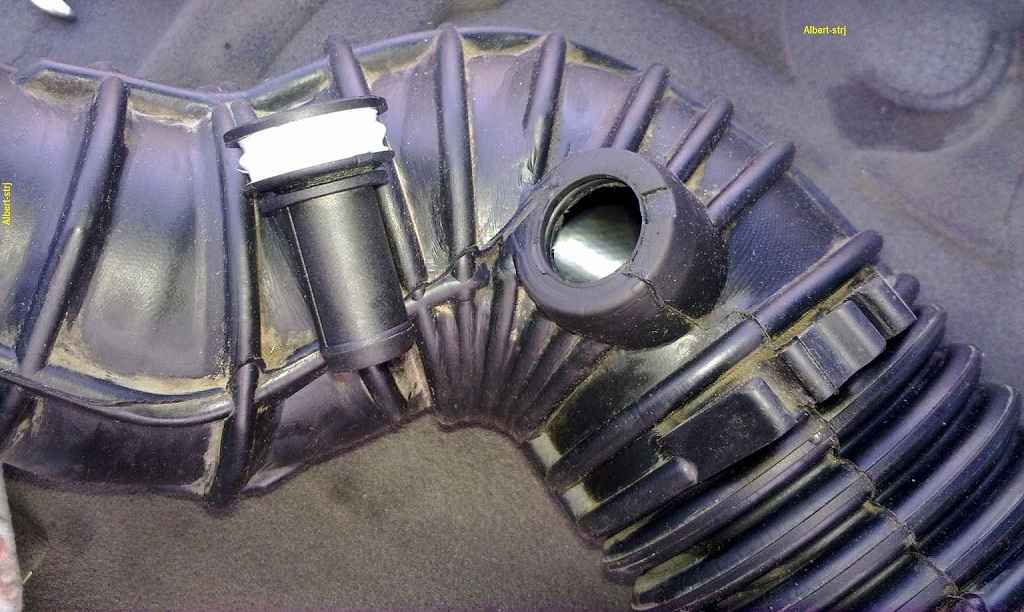

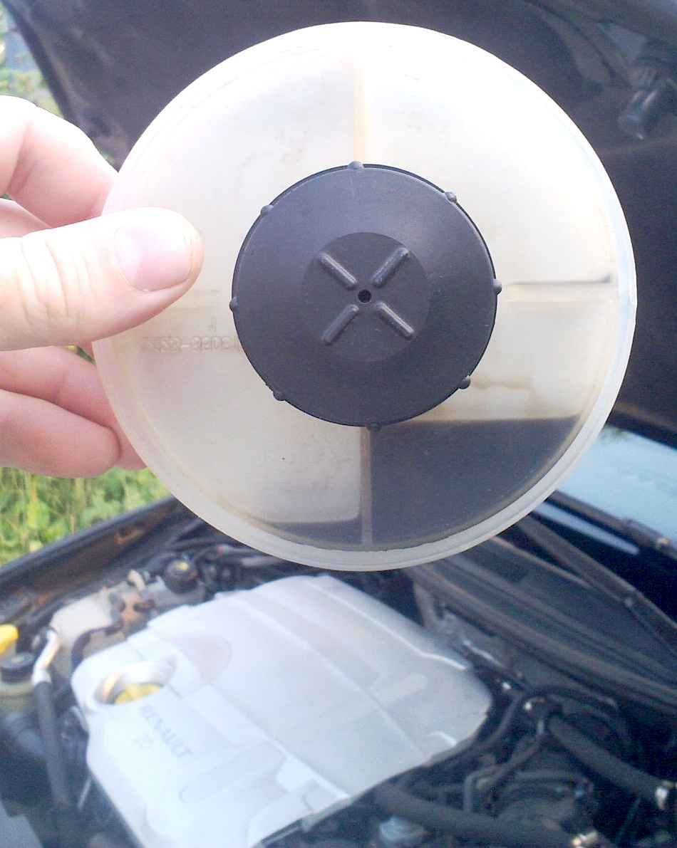

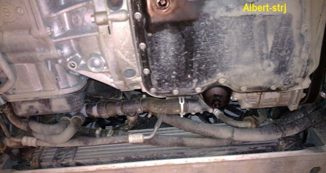

Installed a homemade oil catch tank (Recruited about 70 ml every 3000 km). Replaced the rims and tires 215x55R17 on 215x65R16, changed the configuration of the vehicle (initialized TPMS) and installed pressure sensors tires for winter and summer wheels.

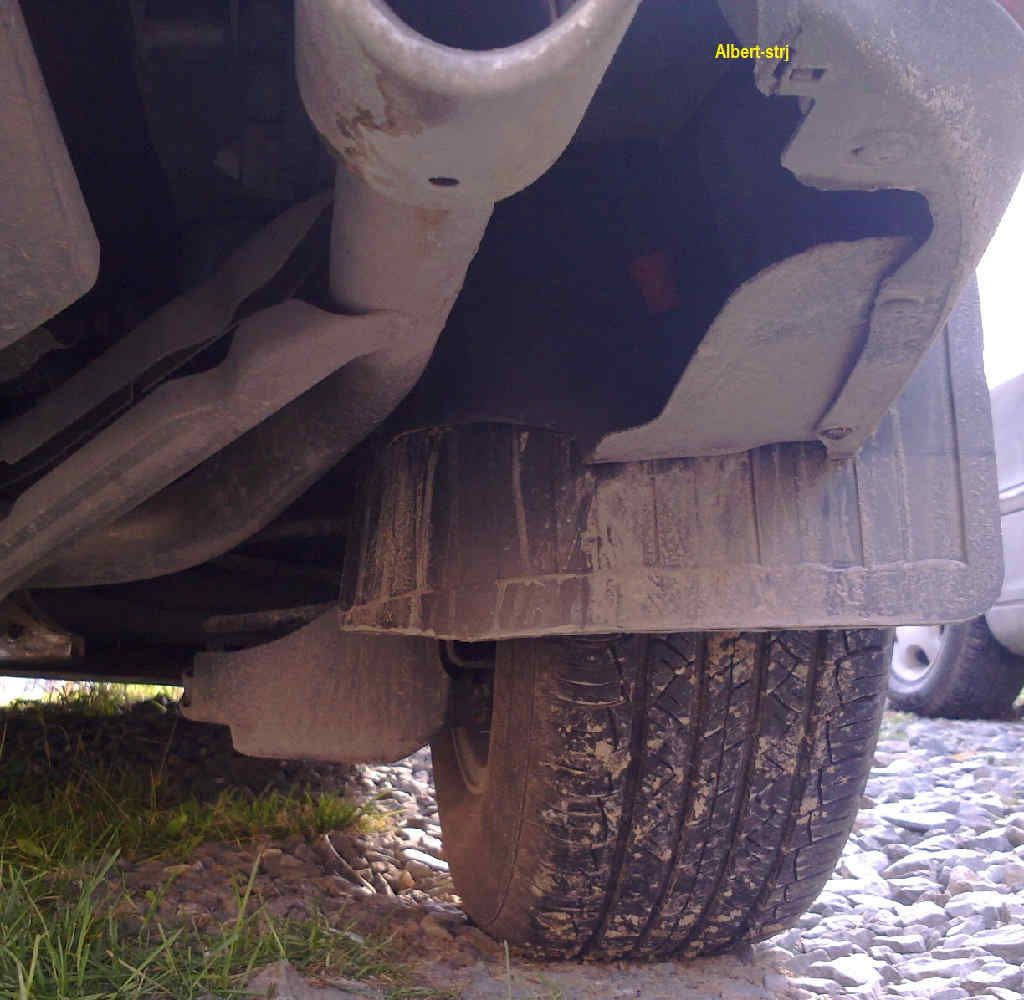

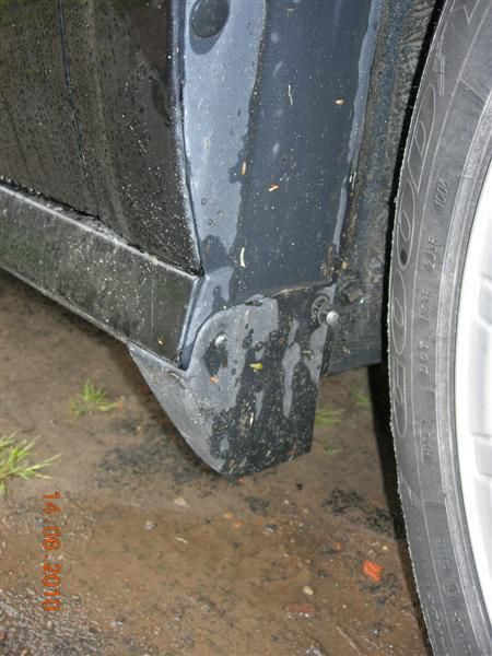

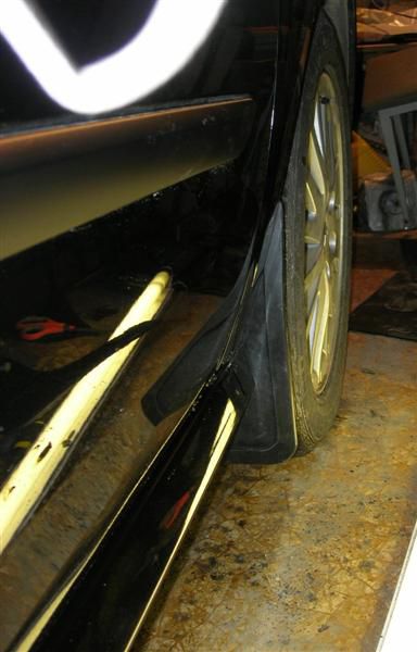

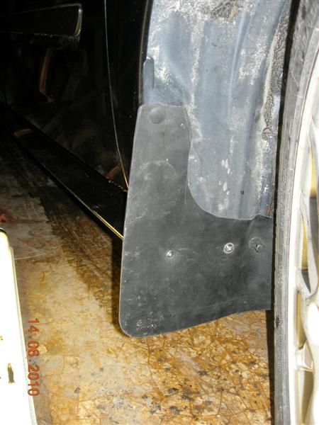

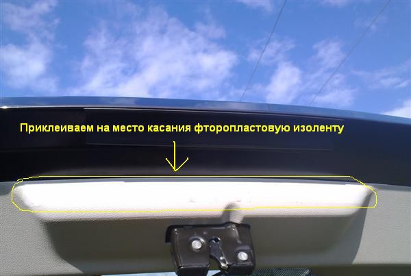

Set these rubber flaps (locker) front and rear.

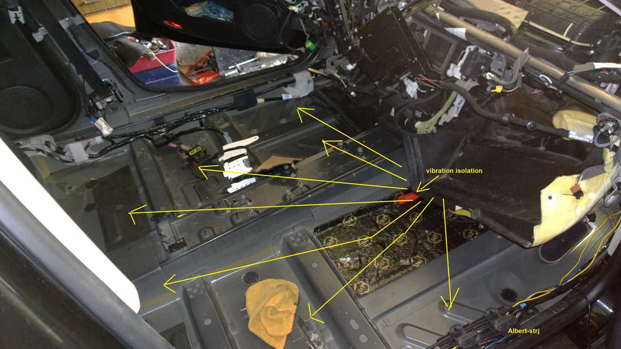

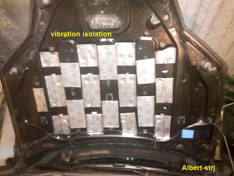

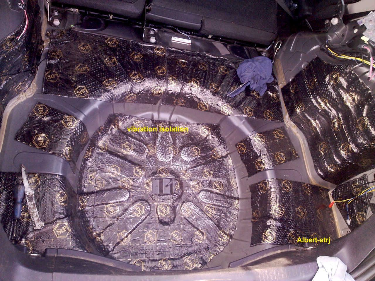

To reduce vibration and noise from the engine set additional vibroisolation.

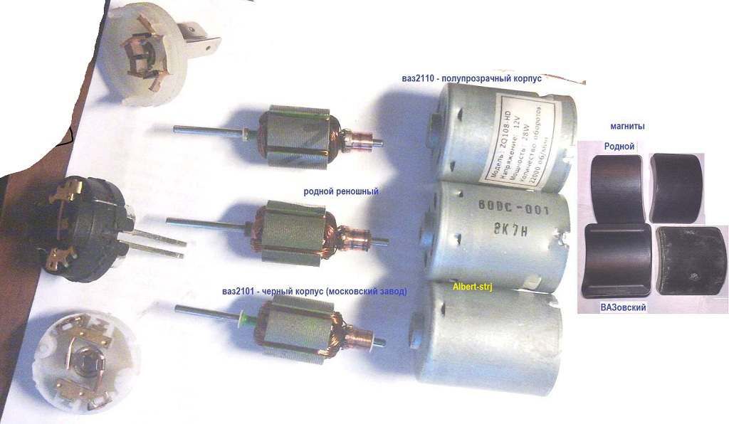

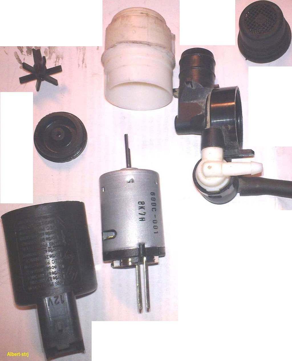

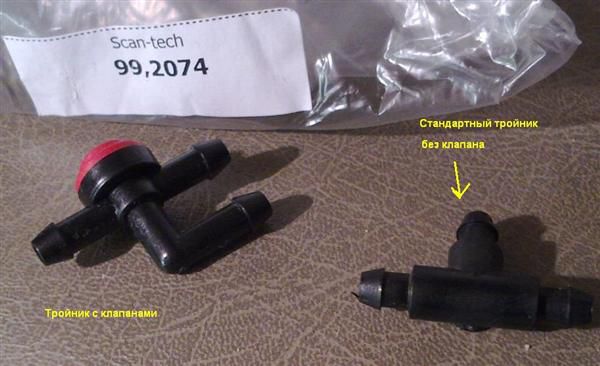

In the cold worked poorly headlight headlamp and windshield replaced in the engine pumps washer on the inside more powerful (28W). Put the valve (99,2074) on the washer glass, this eliminates the delay of the fluid.

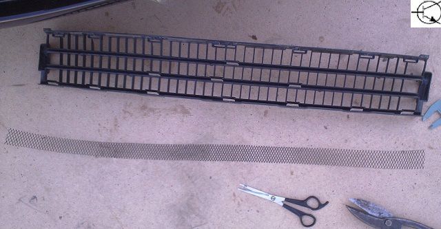

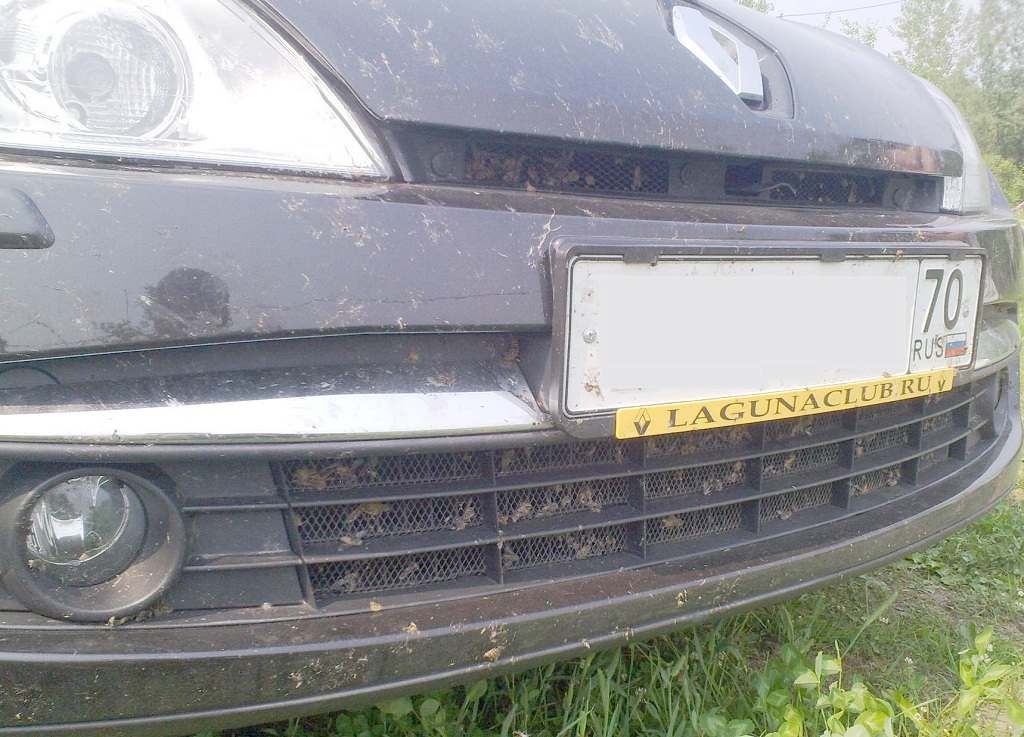

In the summer there are a lot of mosquitoes - has set a fine mesh in the bumper.

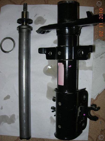

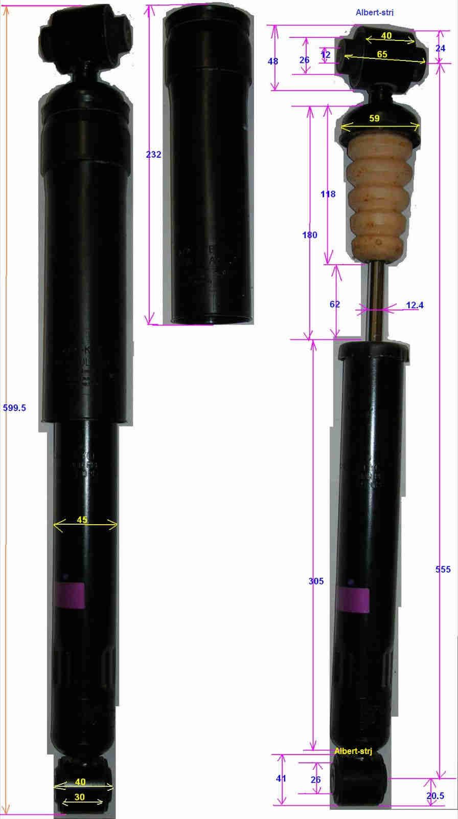

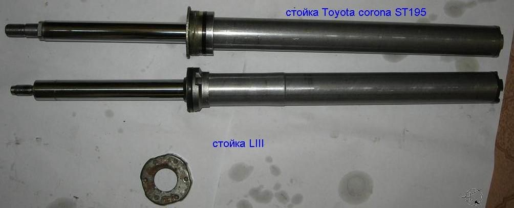

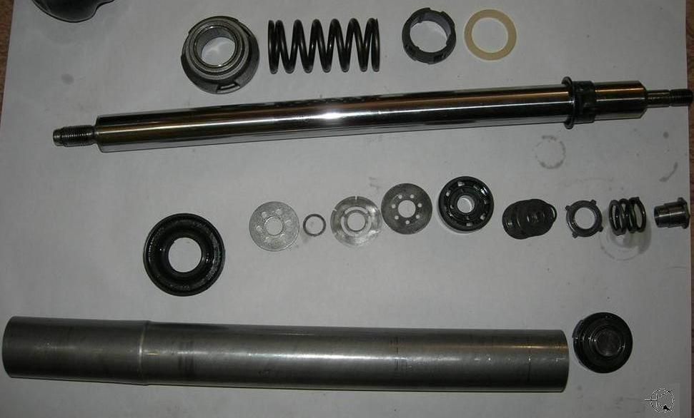

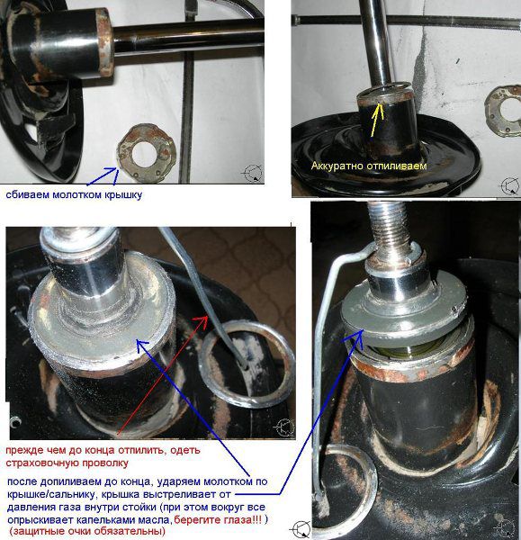

Since 2009 drove 37870 km, 1 time changed the shock absorbers, stabilizer links upper (bet reinforced from Toyota rav4) and lower slewing bearings front struts. Autumn always perform maintenance - change all filters and oil (Elf Solaris DPF 5w30-tolerance RN0720).

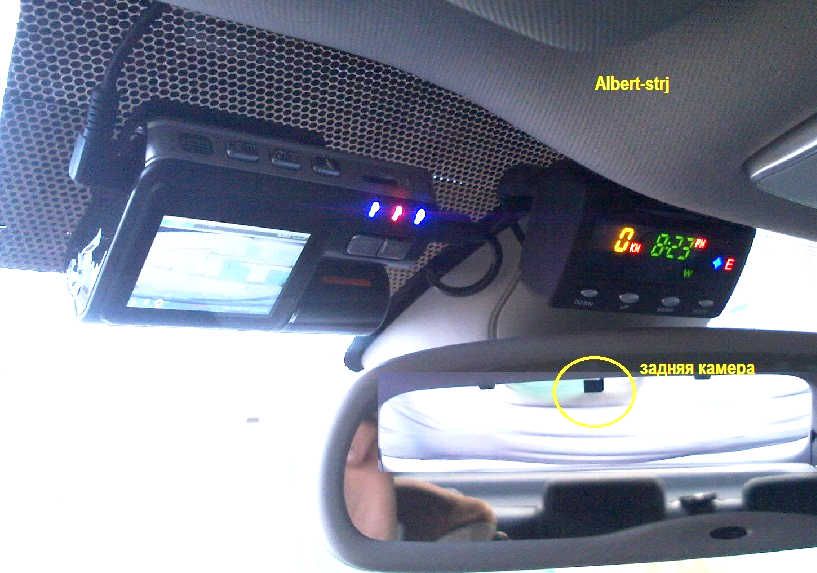

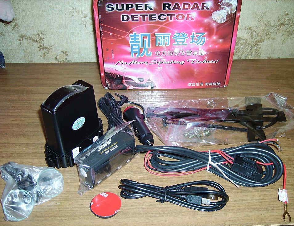

Installed Car DVR F70 and radar detector Conqueror XR-3008.

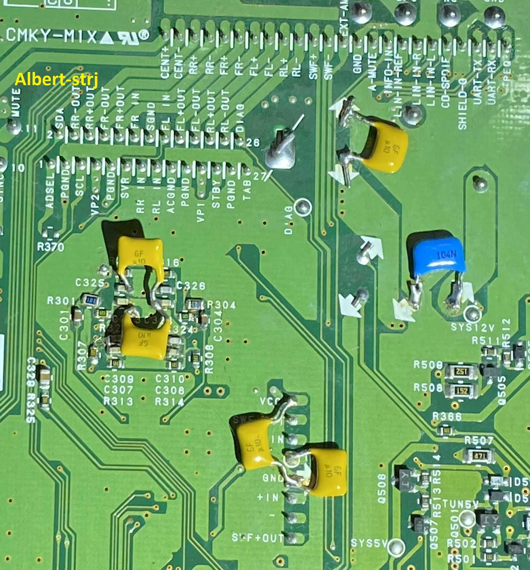

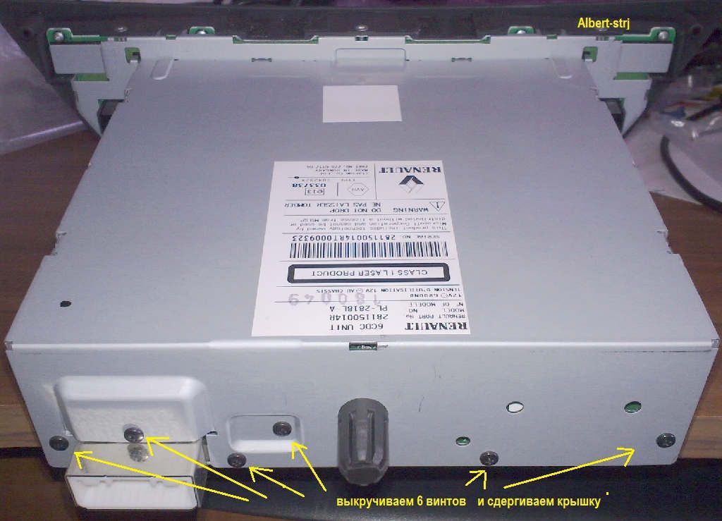

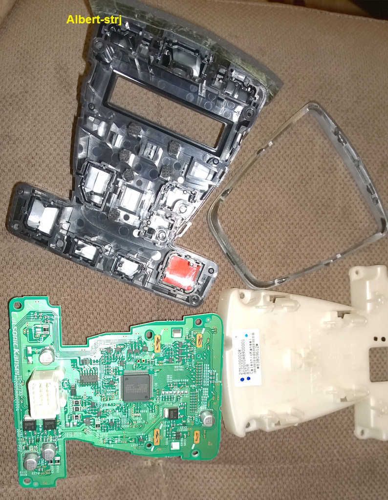

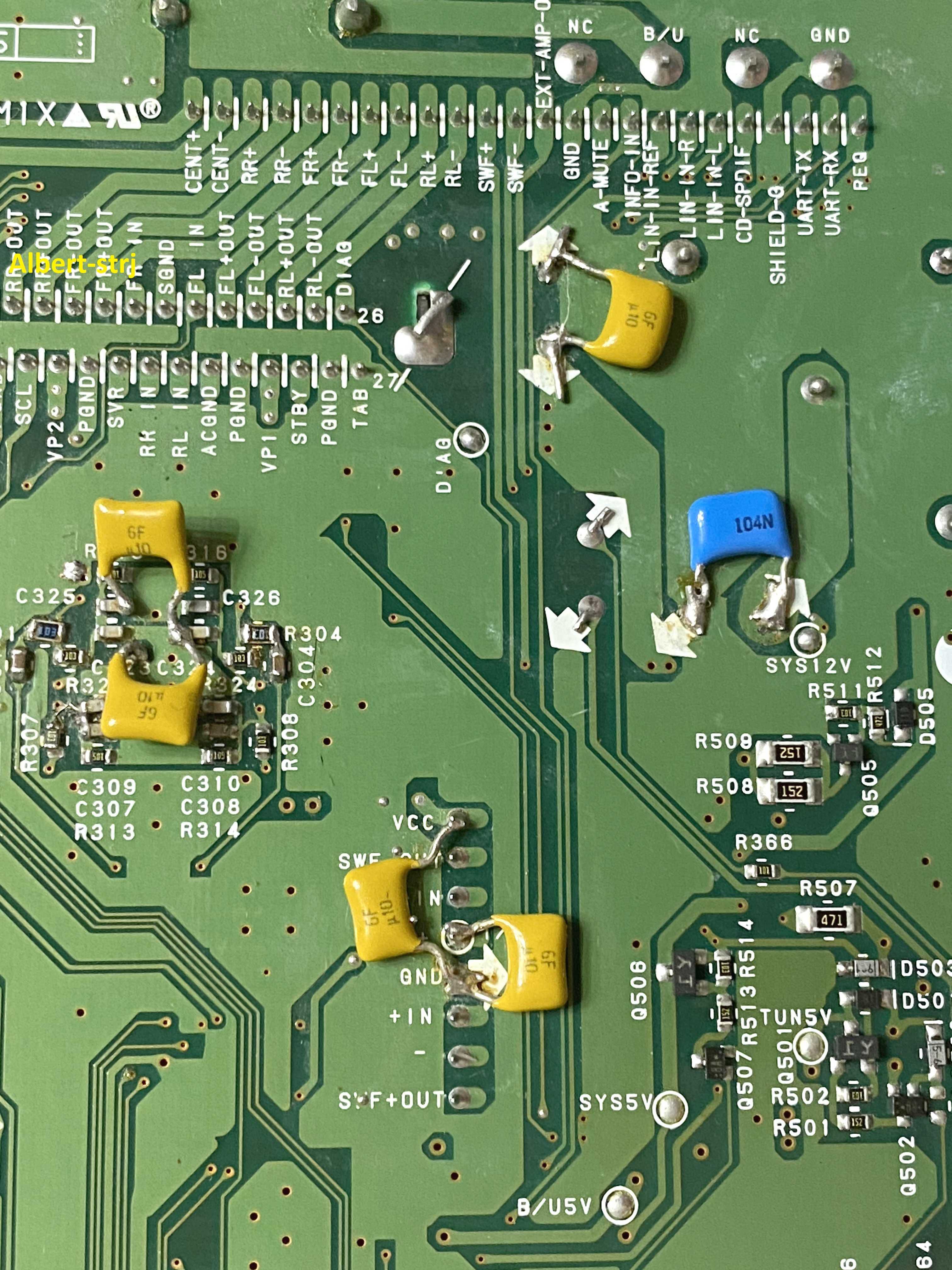

Slightly altered and improved the sound of Cabasse. link

Ps

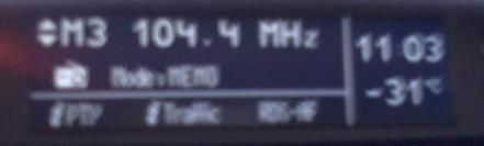

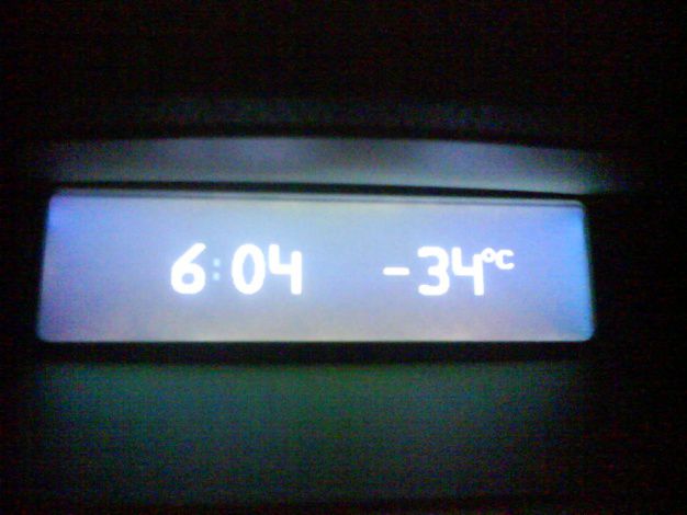

This morning the temperature is -23 started without problems.

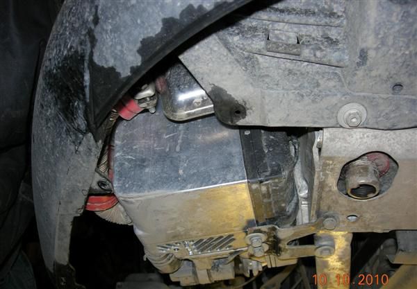

(clairance de 170mm, le chemin de la protection du moteur, protection plastique des conduites de carburant, une puissante batterie, roues de plus grande taille (215х60R16 and 215х55R17), lave-phares. Tout le reste comme sur les automobiles classiques - chauffage de carburant avant le filtre, le chauffage électrique dans le système climatique, sièges avant chauffants).
L'avion à Moscou, a acheté une Renault Laguna III et conduit en voiture à la maison, la distance de Moscou à la maison 3340 km.
Quand est venu à la maison, l'augmentation de la garde au sol à 178mm, a isolé la perte de chaleur salon, moteur et carrosserie.

Quick translation / une petite traduction :D
Pour un usage confortable de la Laguna III dans le nord de la Russie

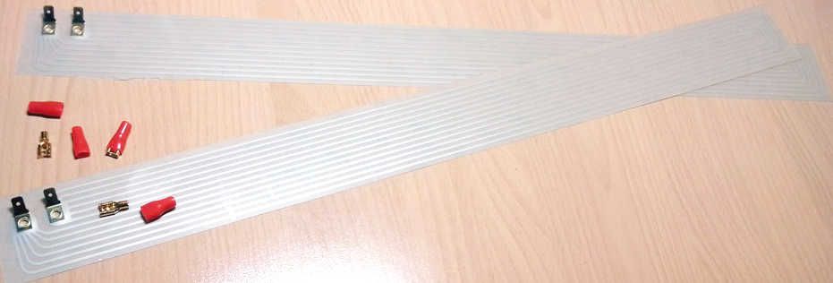

- Installation d'un réchauffeur moteur Webasto 4kW
- Batterie 80Ah 800 A avec adjonction d'eau distillée
- Démontage de l'auto et ajout d'isolants sur le toit et les portes
- Vitre latérales en double vitrage
- En projet: sièges arrières chauffants
- Etanchéité renforcée du capot et du coffre
- Configuration clim modifiée (pays chaud? :pense: )
- Ajout d'une buse additionnelle pour le pied droit du conducteur qui était gelé
- Isolation d'hiver du compartiment moteur sur le dessus et le devant du radiateur
- Installation d'un absorbeur d'huile fait maison (70 ml recueillis en 3000 km)
- Remplacement des Roues 215x55R17 en 215x65R16

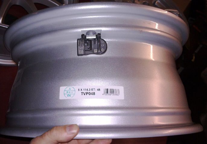

- Activation du SSPP et ajout de valves à capteurs sur roues d'été et d'hiver
- Pare boues/neige avant et arrière
- Garde au sol rehaussée à 178 mm

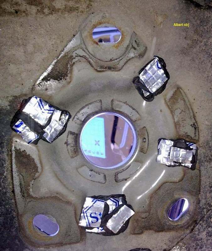

- Ajout d'isolant acoustique pour le moteur

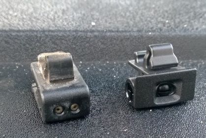

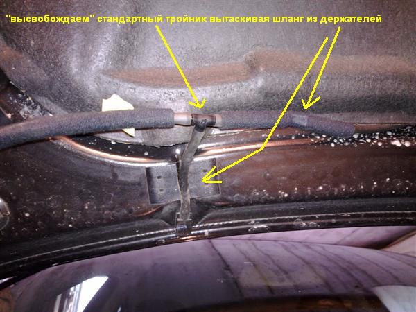

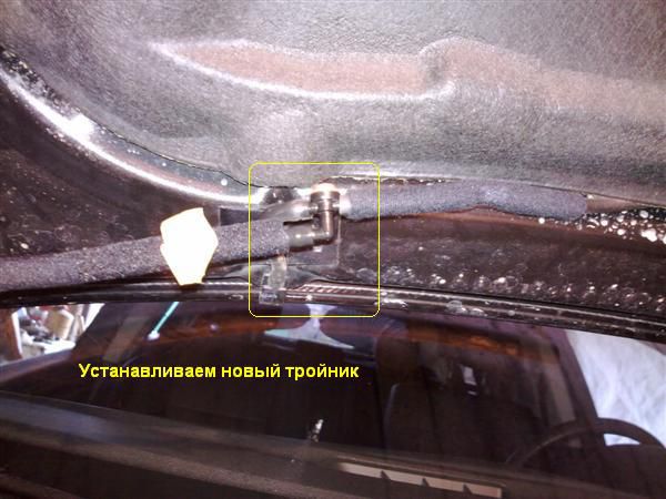

- Les laves glace et lave-phare marchaient mal au froid: remplacement de la pompe par une plus puissante + déplacement du clapet pour supprimer le retard d'arrivée du liquide
- Pour protéger le bouclier des moustiques en été, ajout d'un grillage fin
Maintenance
- En 38000 km depuis 2009, changement des amortisseurs, des silents blocs de barre stabilisatrice (remplacé par des pièces de Toyota RAV4) et des pivots de jambes de force.
- Vidange tous les automnes en Elf Solaris DPF 5w30-tolerance RN0720
- Installation d'une caméra avant et d'un détecteur Infra rouge arrière
- Modification Cabasse pour améliorer le son

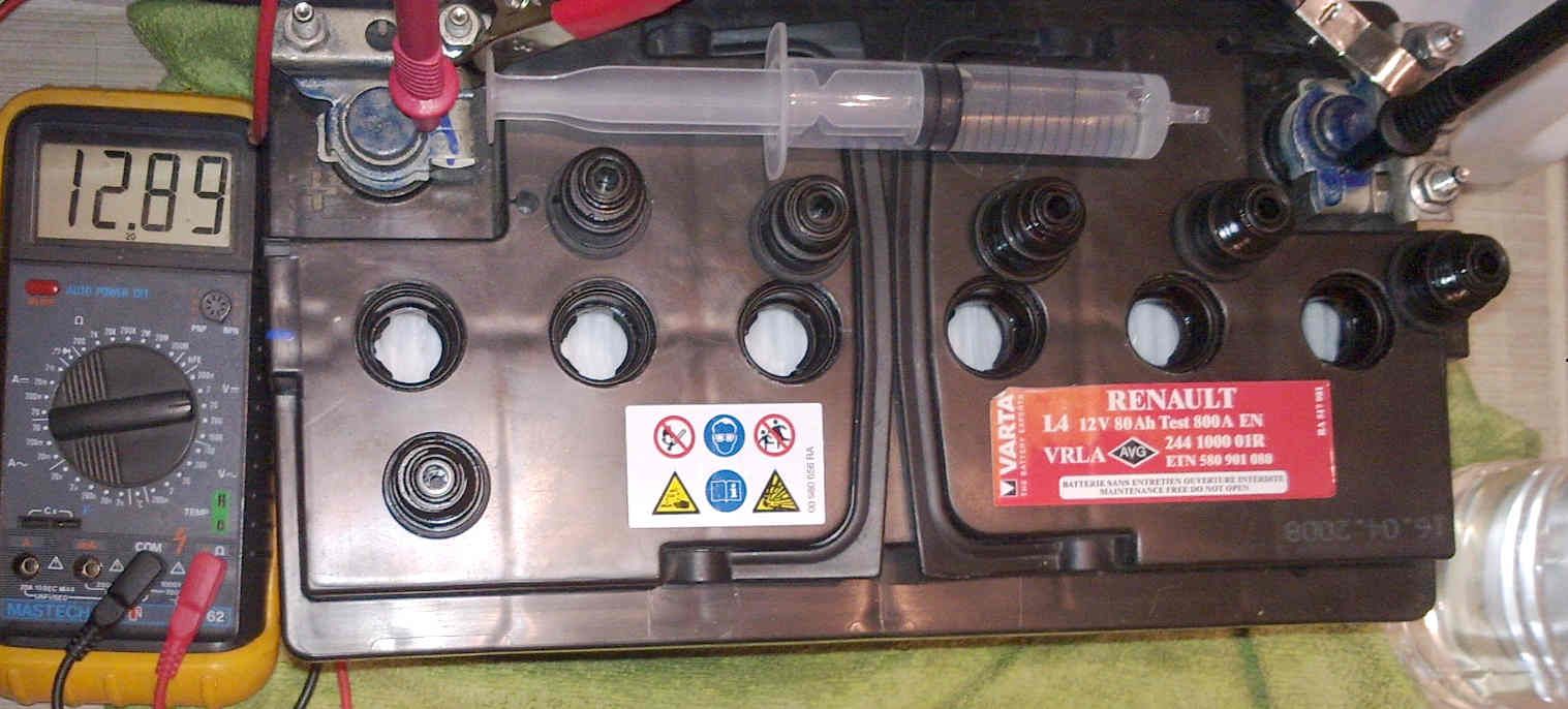

dans l'AGM la batterie de l'eau distillée est ajoutée uniquement lorsque le tapis à l'intérieur de sécher

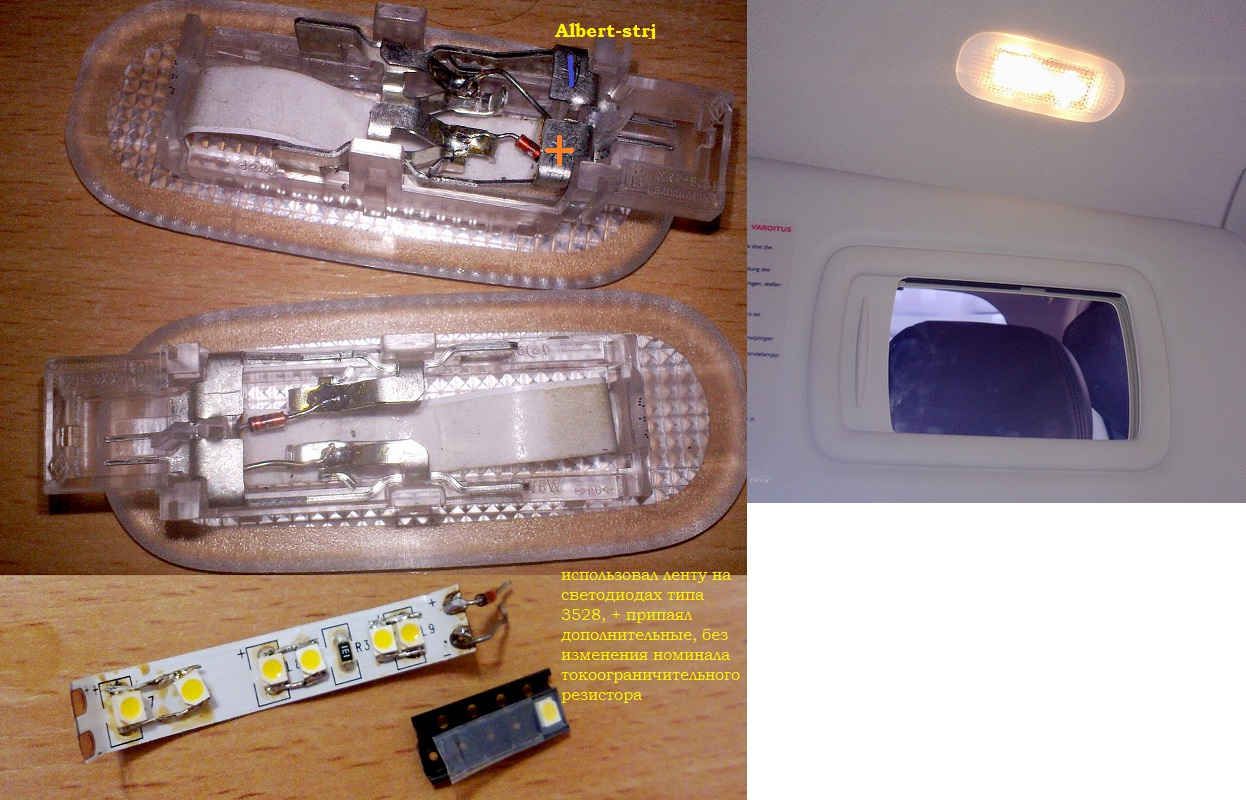

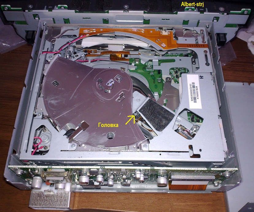

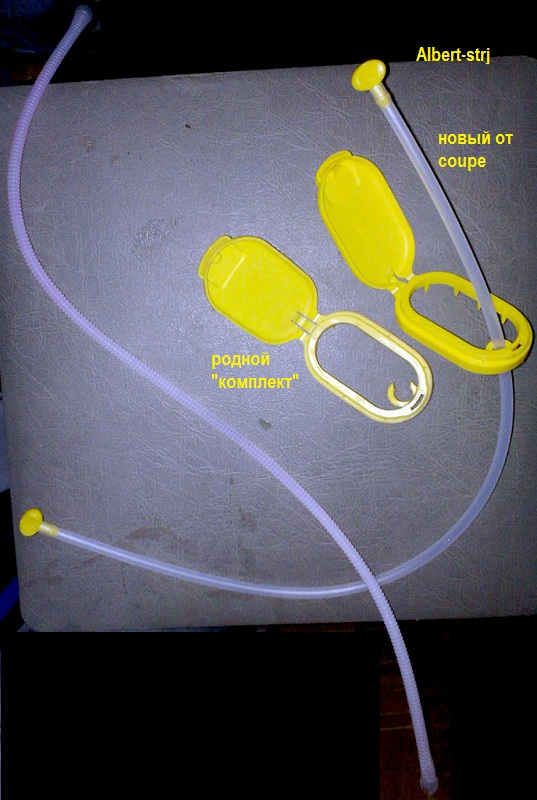

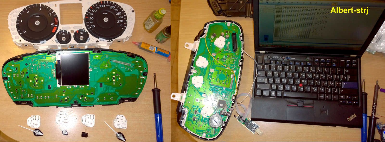

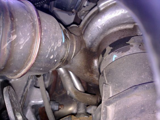

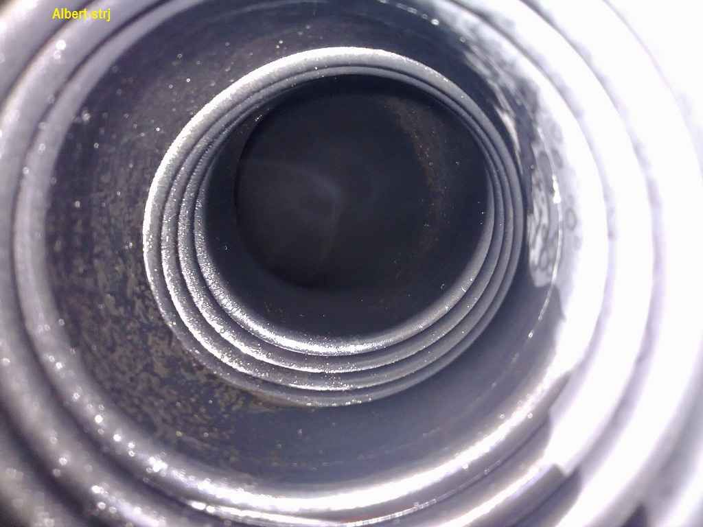

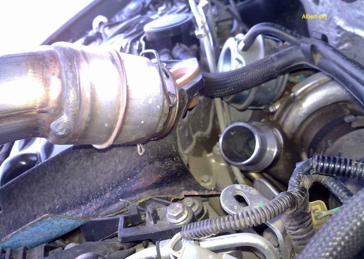

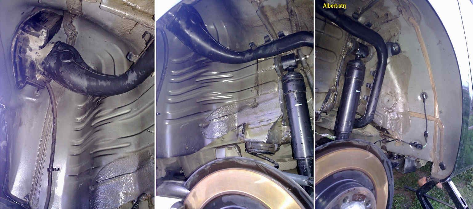

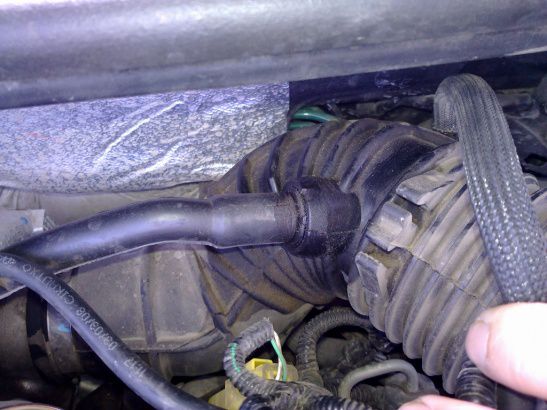

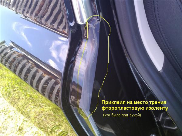

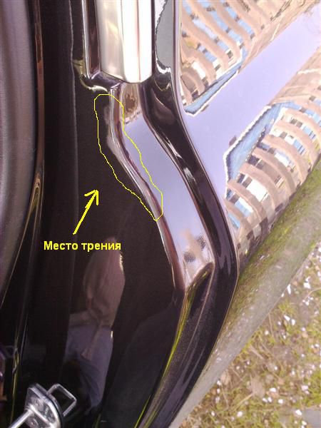

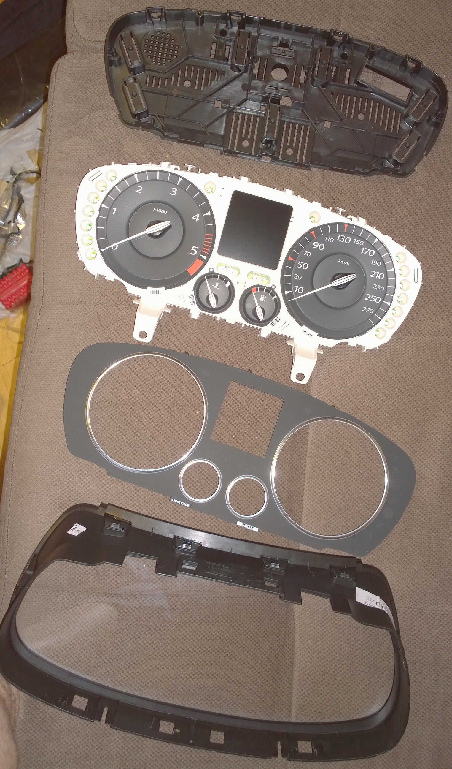

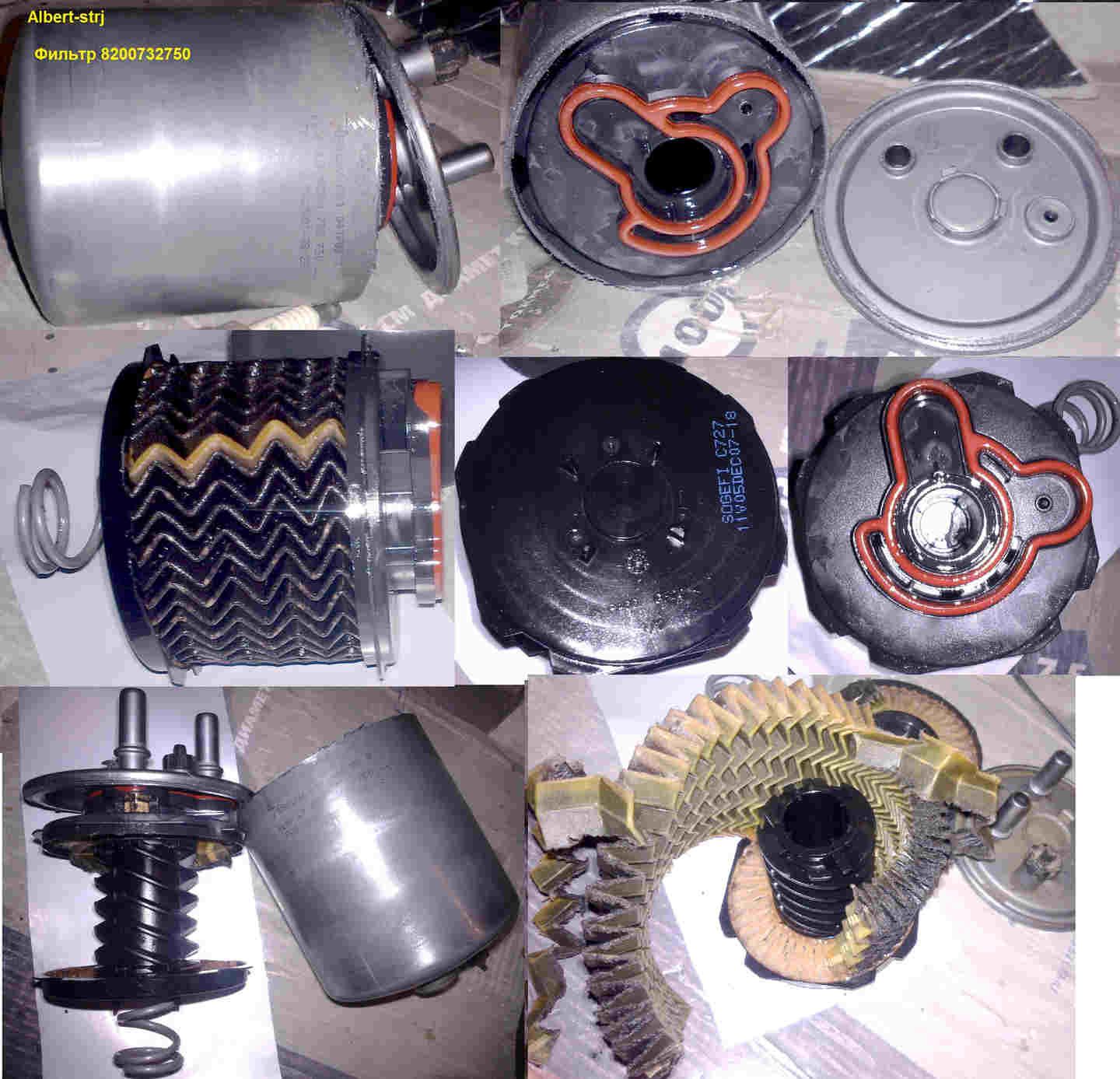

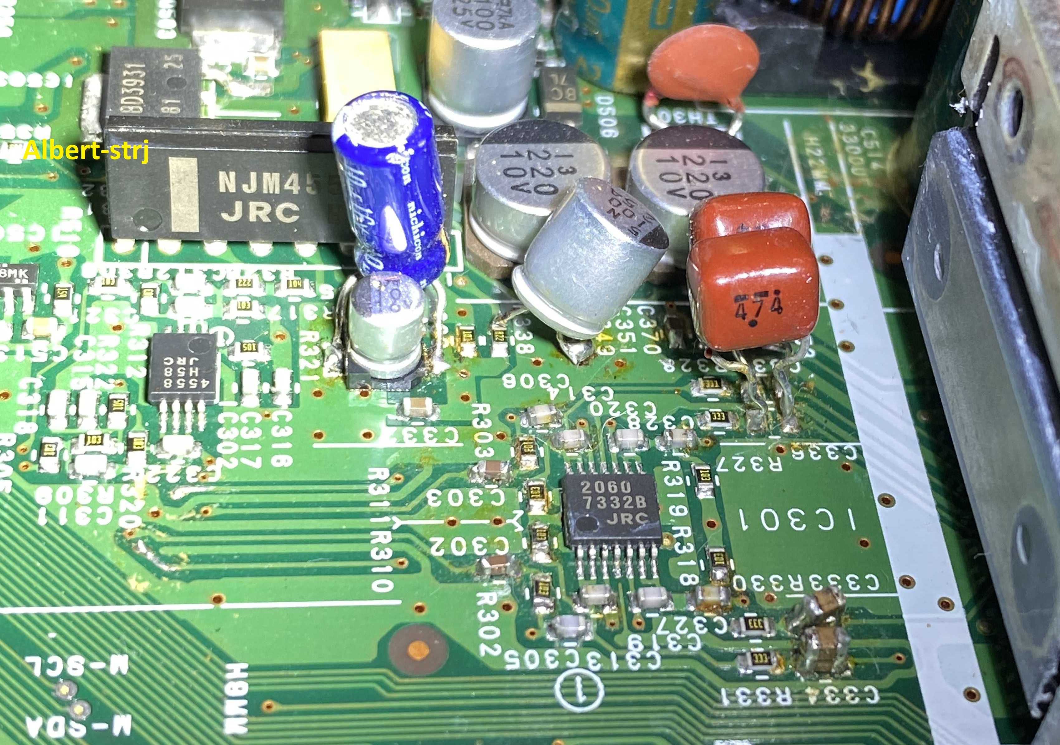

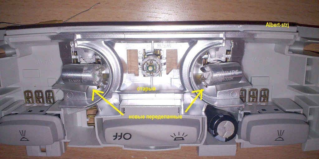

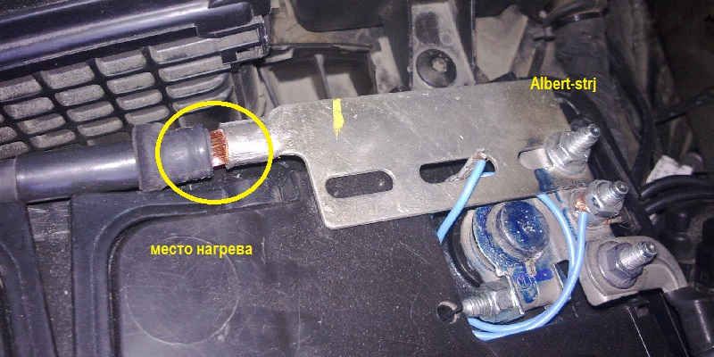

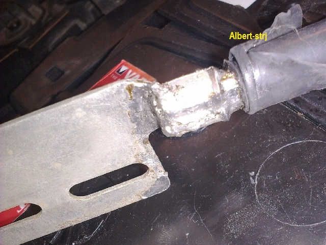

ci-dessus indiqué n'est pas tous les travaux qui passait avec la voiture, en fait, était plus grande, par exemple:

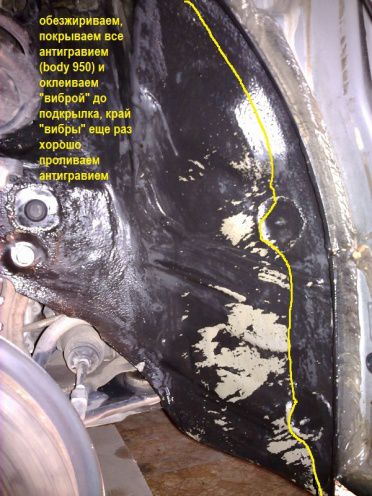

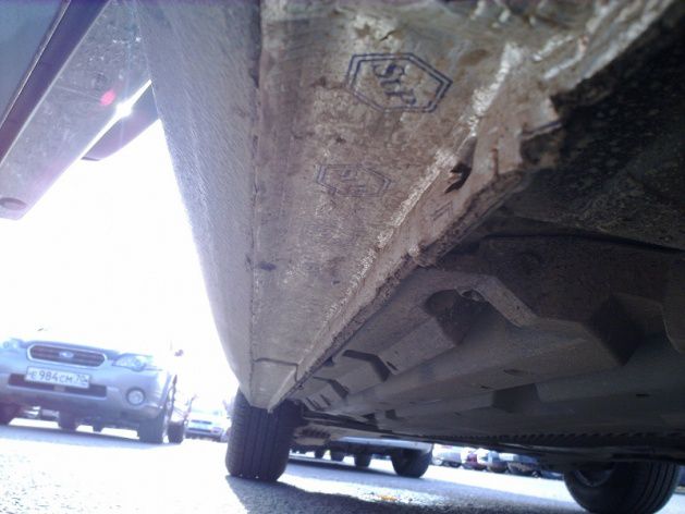

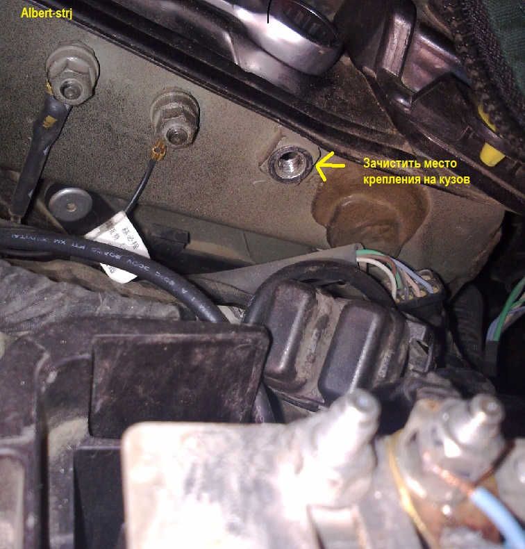

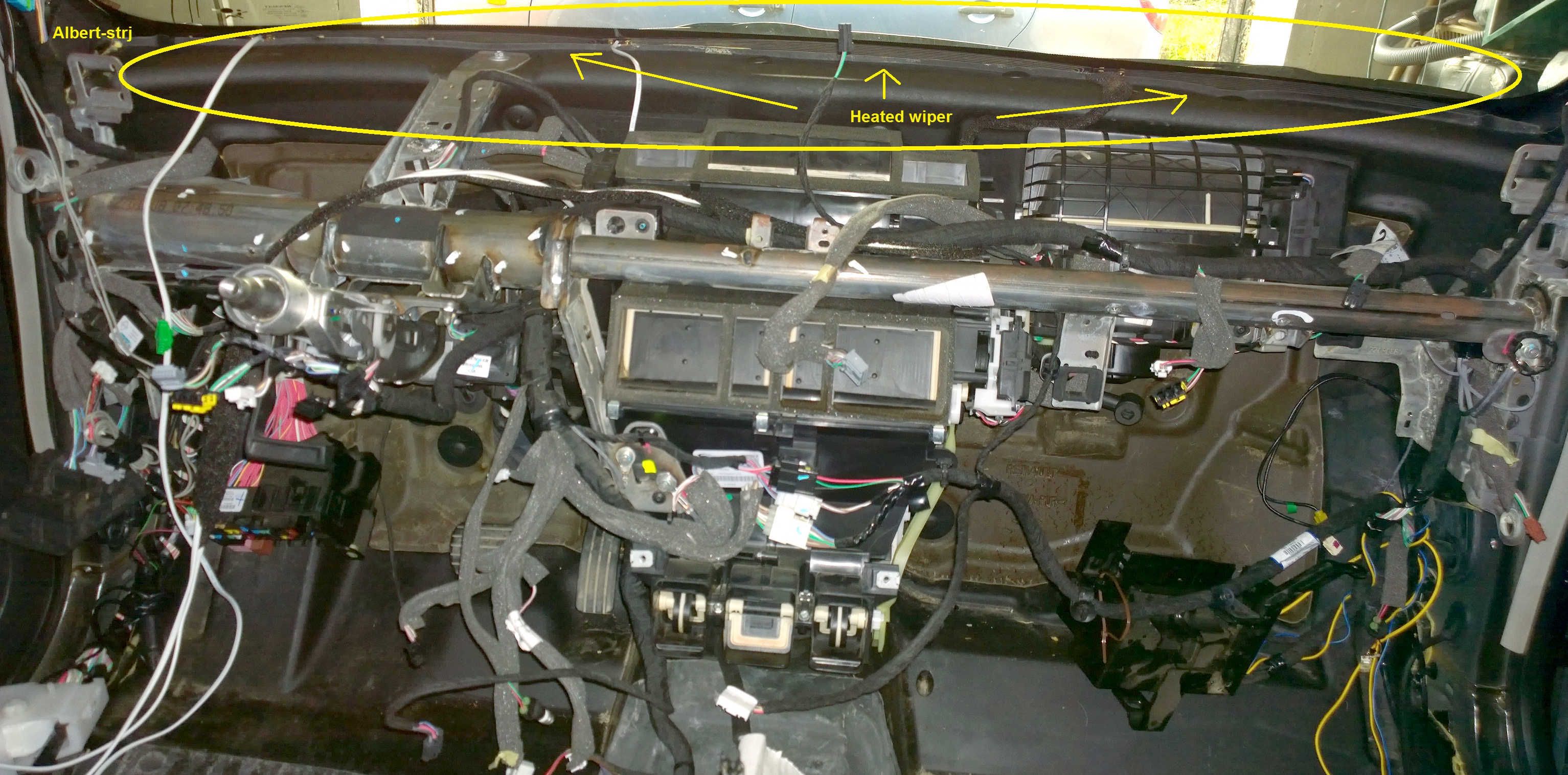

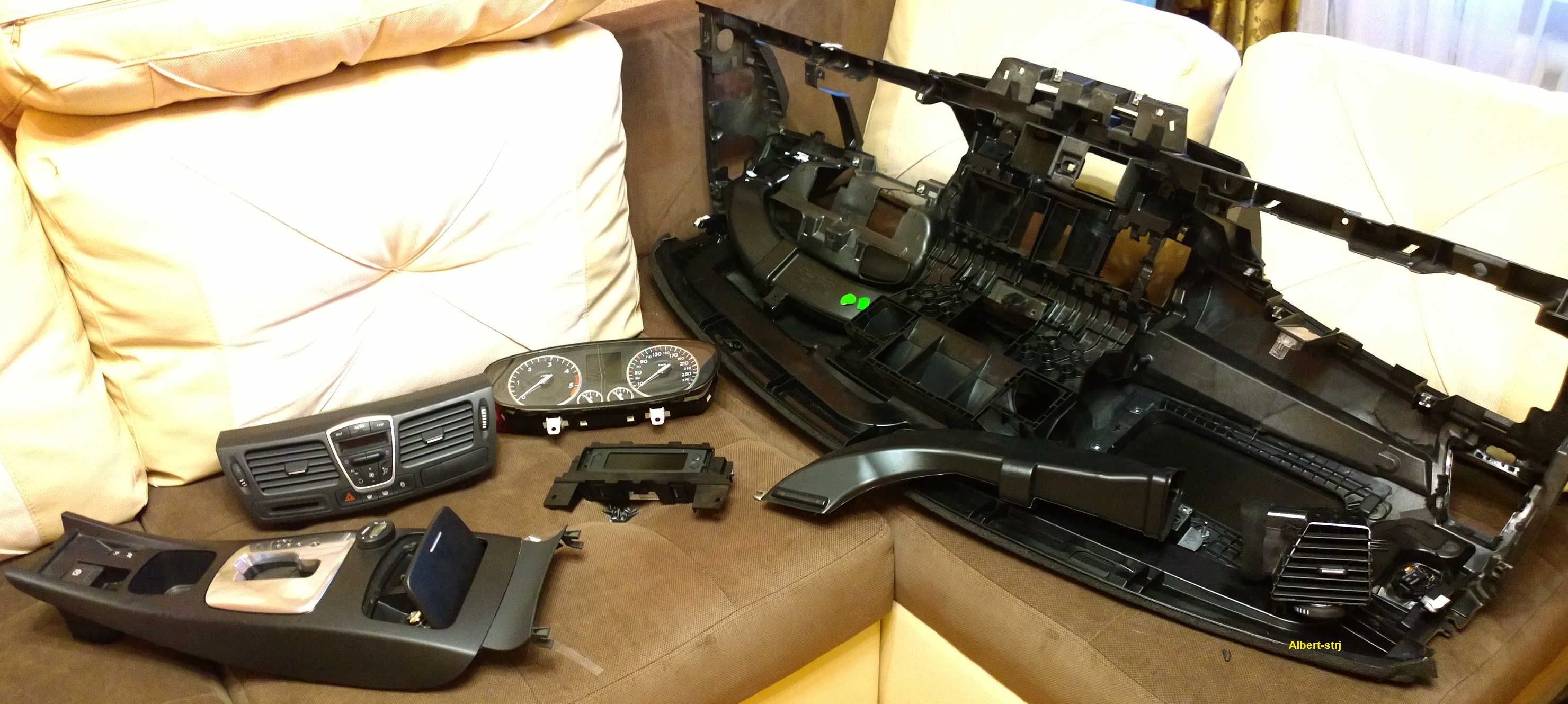

- résout les erreurs de conception de la voiture dans le cadre de la protection de la carrosserie et du compartiment moteur, de la saleté de la route;
- il trouvé la raison pour laquelle les amortisseurs avant de frapper (le ressort de la valve de гидробуфера de plus petite taille que la normale - erreur de conception);

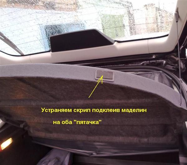

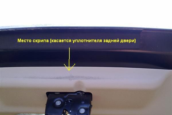

- devait porter un coup de craquements et bruits dans le salon à cause de la faiblesse de la torsion de la carrosserie de la voiture

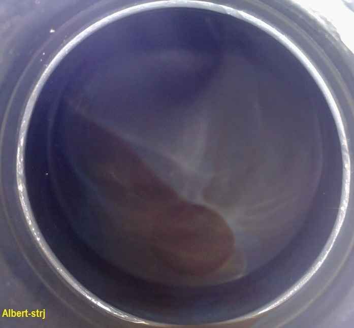

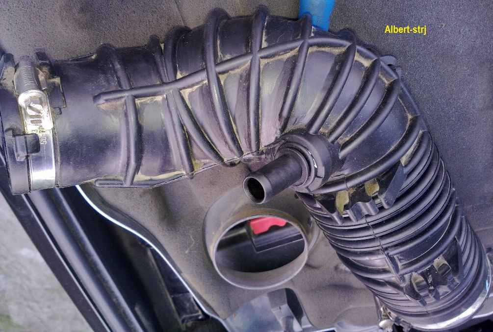

- l'élimination de la mauvaise nettoyage des gaz de carter (constructive maladie m9r);

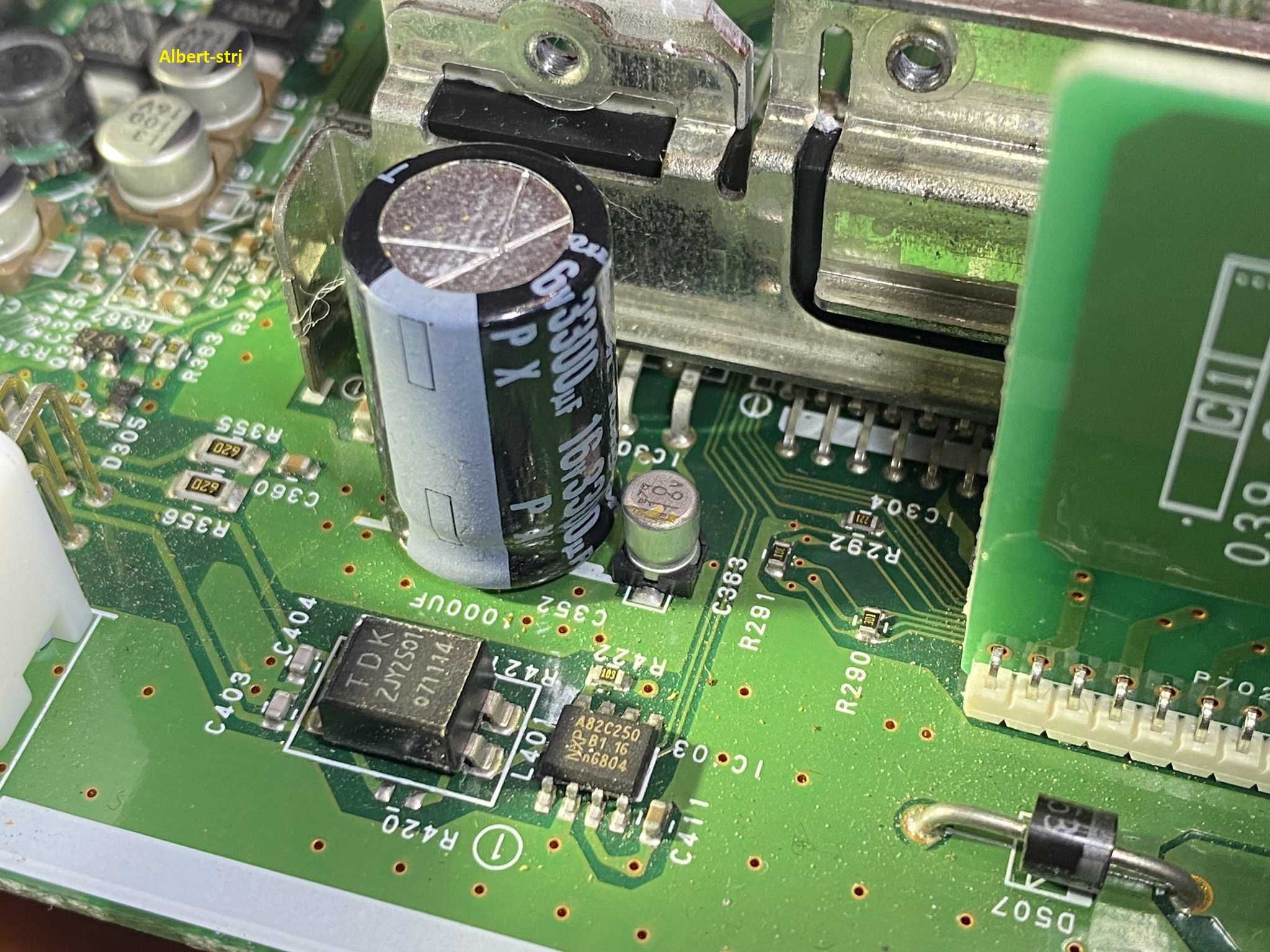

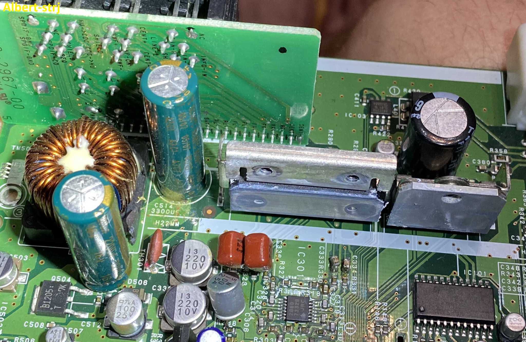

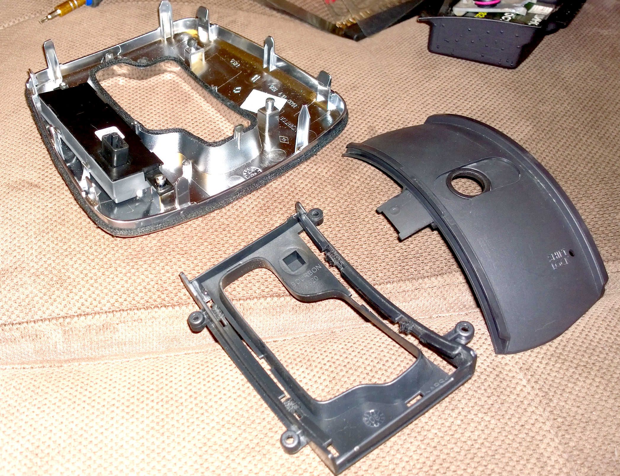

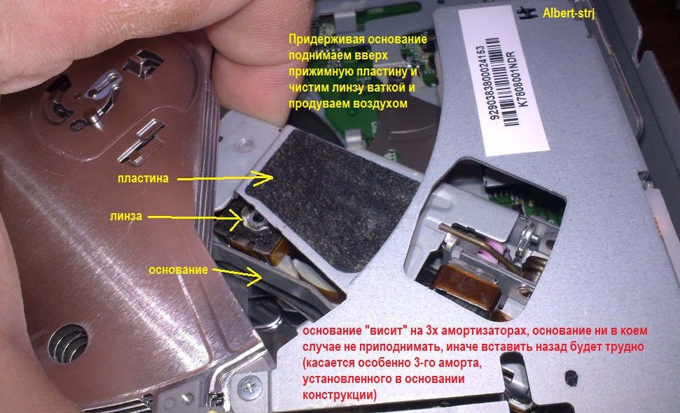

- nettoyer le lecteur 6CD cabasse;

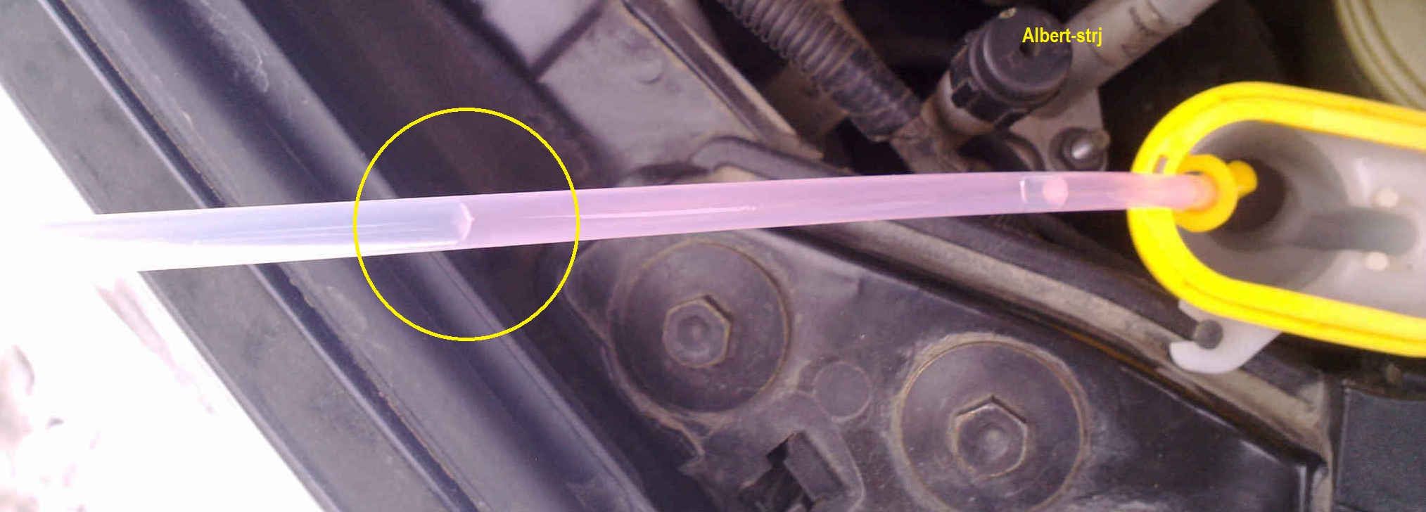

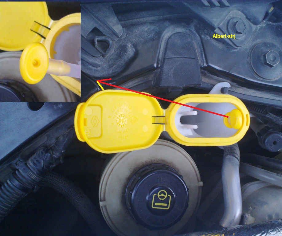

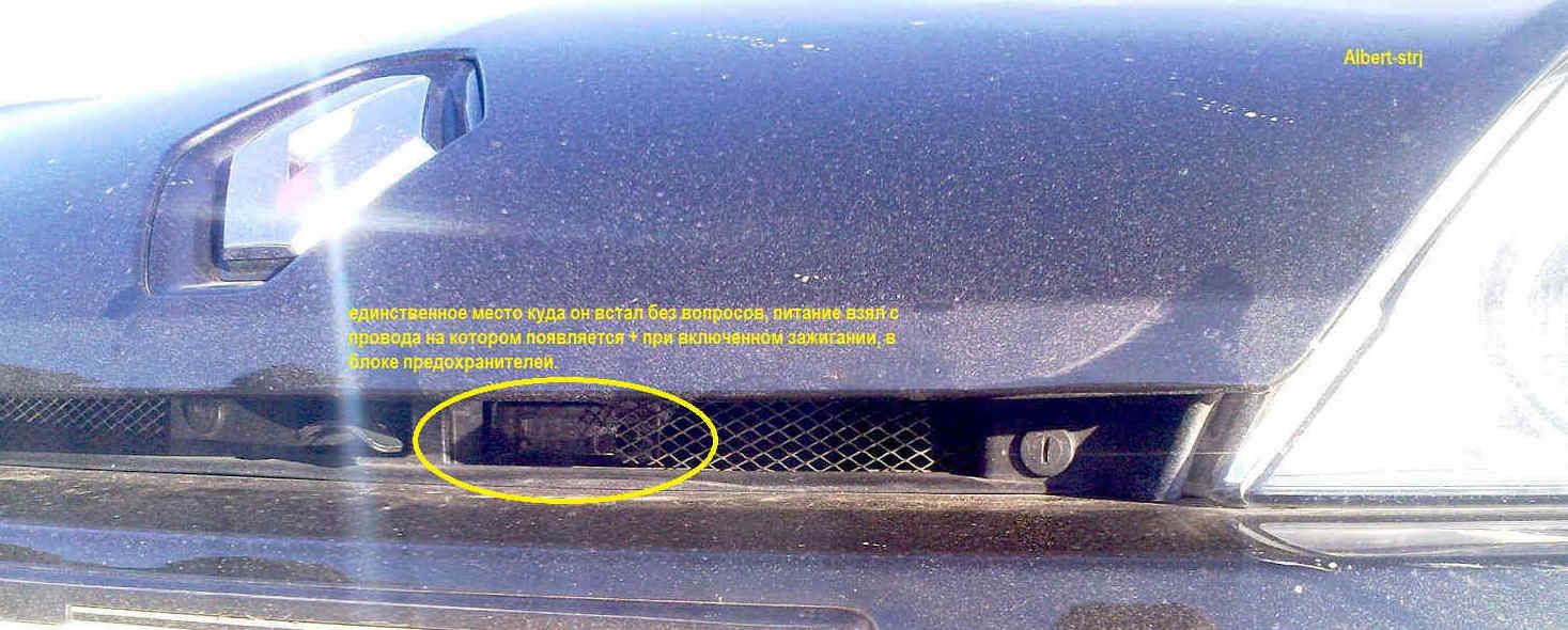

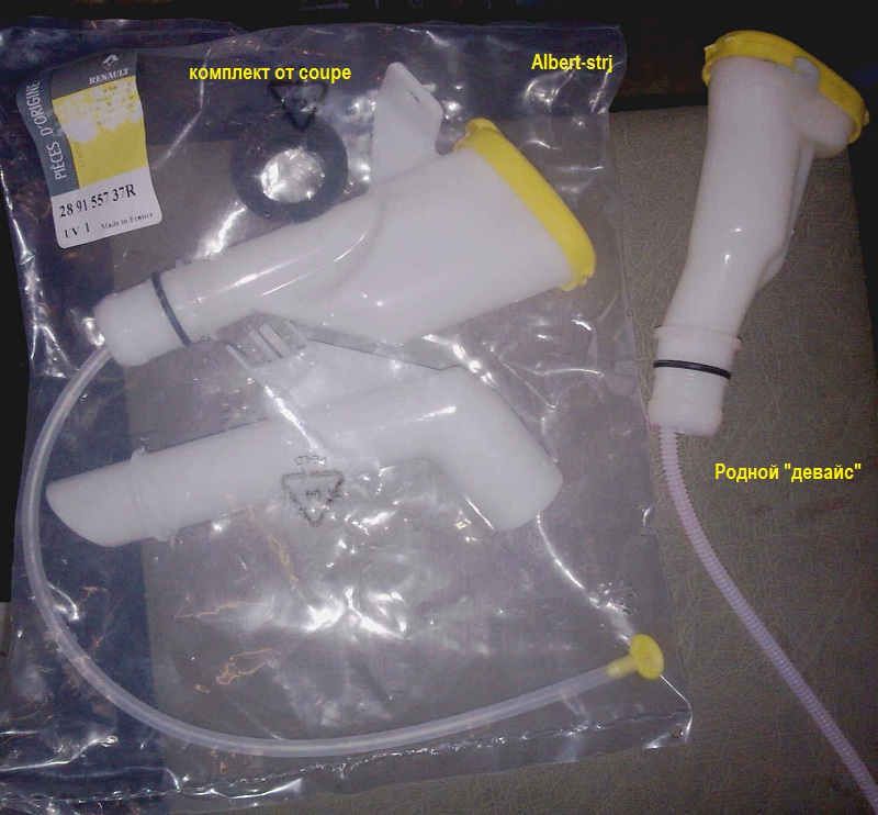

- installé pour la mesure de niveau de liquide de lave-glace de la renault laguna III coupé (code 289155737R);
- installé compteur d'heures de service du moteur;
- éliminé mauvais contacts de la batterie et la carrosserie du véhicule (ce qui exclut les erreurs de la partie électrique);
- installé à gazon gicleurs du lave-glace de pare-brise de la Renault Kangoo II (code 8200600847);

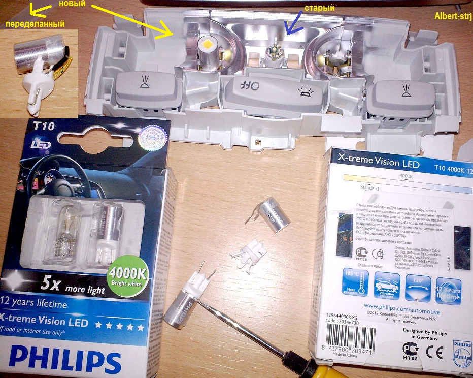

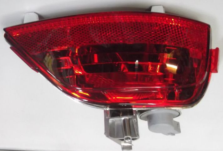

- installé à droite de brouillard avec une ampoule (code 265800001R de la laguna III avec le volant à droite), branché une ampoule à gauche de la gauche, avant - maintenant dans le brouillard s'allument tous les deux de la lanterne.

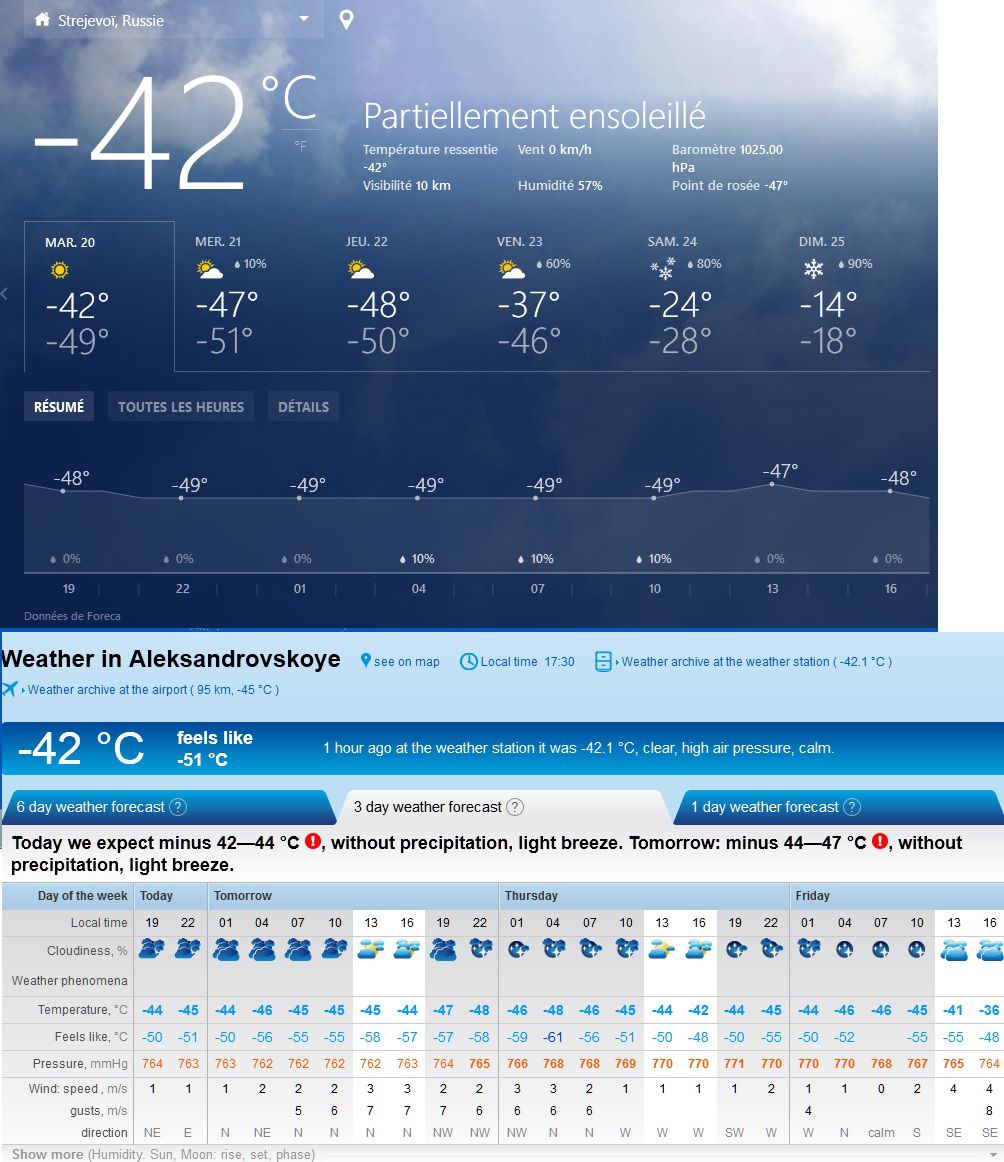

Renault Laguna III nous avons seulement 2 pièces dans le quartier (une tondeuse à essence et un diesel). Beaucoup de rencontre Logan de Renault et de Renault Duster, mais, le japonais Toyota utilise beaucoup plus. Et il est considéré que la fiabilité des voitures japonaises mieux que les européens.
(1992 j'ai utilisé 3 russes de la voiture - Lada 2103, Lada 2105, Lada 21063 et 3 japonais de la voiture analogues avec la bonne administration de Nissan Synny, une Toyota Carina E, Toyota Avensys. Maintenant, j'utilise Renault Laguna III et Lada 2106).
Des températures de -40 et au-dessous de degrés chez nous, principalement, sont utilisés seulement les russes, les voitures japonaises. Lorsque la chaleur (environ -25 degrés et plus) se rencontrent sur la route des voitures de toutes marques.
ps
Renault Laguna III we have only 2 things in the city (one gasoline and one diesel). A lot of common Renault Logan and Renault Duster, but the Japanese Toyota used much more. And it is considered that the reliability of Japanese cars better than their European counterparts.

Je suis très curieux de savoir comment vous mettez le TPMS de capteurs de pression!
Les hivers sont très froid en Russie. Peut-être que les Renault commercialisés en Russie n'est pas les capteurs de mesure de pression pneumatique.

Couinements Removed, clique sur le panneau avant. Installé intérieur isolation du bruit de vibration.
Tous démontés, joints lieu en plastique collé du ruban adhésif en toile.
clic pour agrandir clic pour agrandir clic pour agrandir clic pour agrandir clic pour agrandir
Je mets les essuie-avant chauffants. Connecté à la fenêtre chauffage arrière.
215x60R17 pneus michelin latitude tour hp.
Amortisseur dynamique de la suspension avant. Bruit mauvaise route réduite.

Priviet Albert!
metoda_esli govorish po russki mogu prislat instrukciyu
Bravo très joli travail que tu as effectué sur ta Laguna3 cher Alber-strj.
Vraiment tu as été très courageux de démonter l'habitacle de ta voiture, donc avec ces travaux il y a moins de vibrations en roulant avec ta Laguna maintenant :!:
Super reportage photo

Message Mar 20 Dec, 2016 12:12
:shock: :shock: :shock:

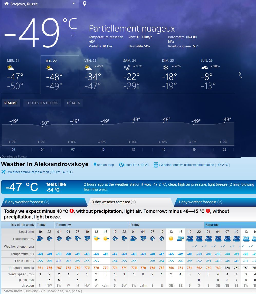

:lol2: :lol2: :lol2: Juste un peut froid cher Albert :shock: , -42 degré celsius , le jours ou il fera cette température en France nous serons tous gelés :lol2:
Aujourd'hui il fait 4 degré en Périgord.
J'espère que ta Renault Laguna 3 roule toujours aussi bien Albert.
Laguna III, pour chauffer la cabine, vous devez utiliser le moteur de 30-40 minutes. Après cela, le moteur ne s'éteint pas toute la journée.
Aujourd'hui, il est encore plus froid.
Laguna III, ne peut pas montrer à l'écran des températures inférieures à -40. :lol: :lol2:
