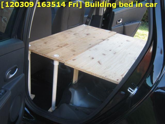

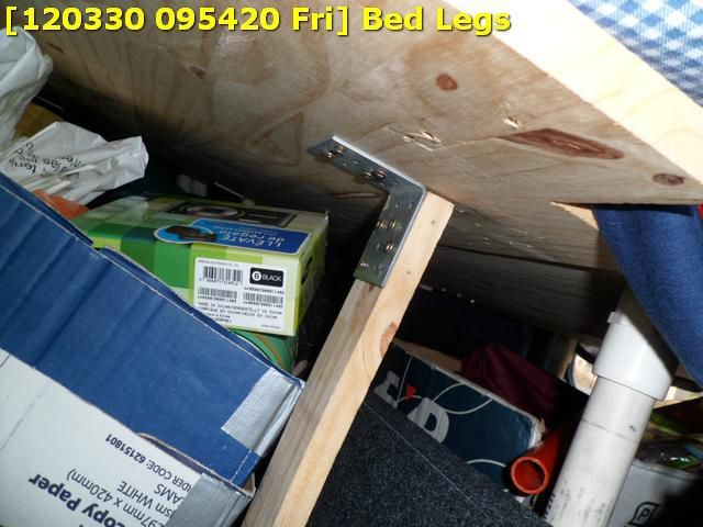

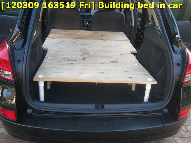

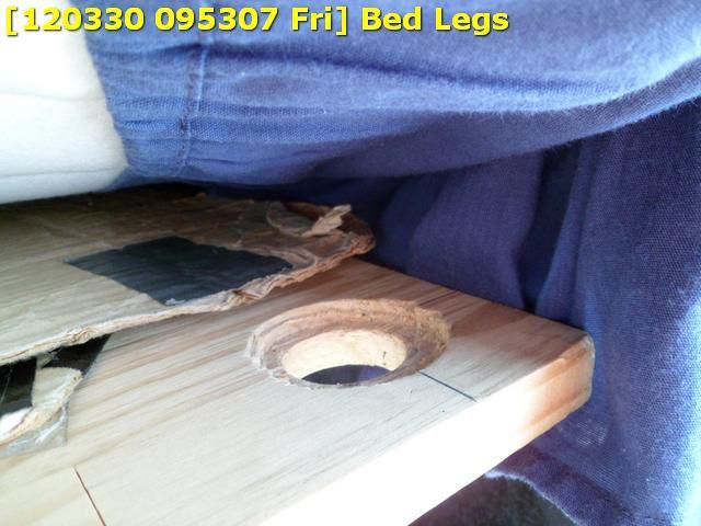

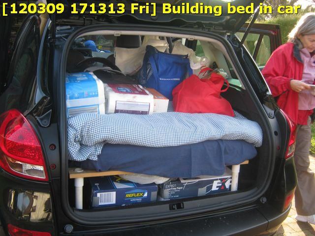

Message Jeu 20 Déc, 2012 01:47:35
Thank you for your replies. I have decided to lease a Clio 4 for our 4 month trip from Paris to Riviera, east coast of Italy, southern Greece, Turkey, Bulgaria and Romania and then back to Paris.
I will let you know how I go adding a bed.

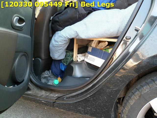

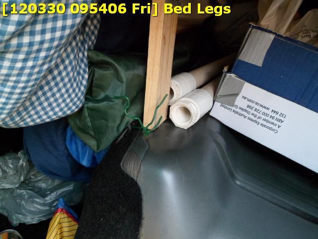

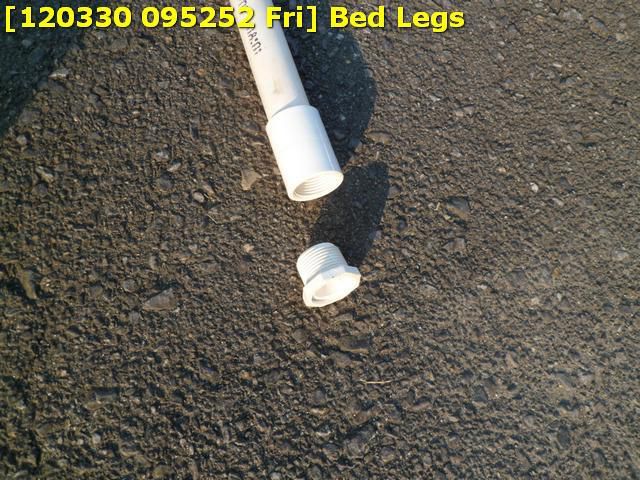

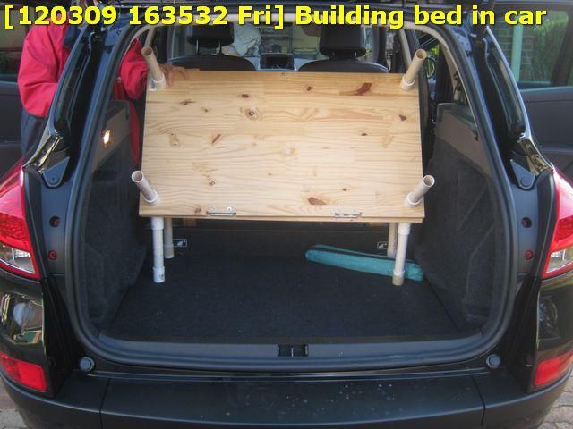

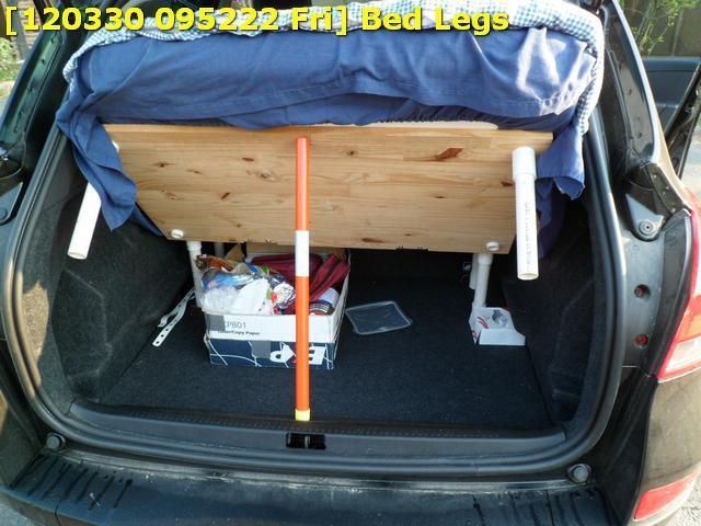

Here are some photos of the bed in our Clio 3.
Andrew Watson
Perth, Western Australia

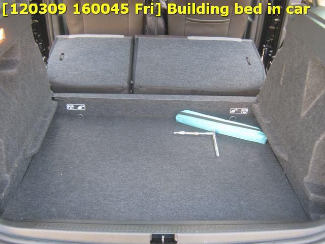

Localisation: Australia

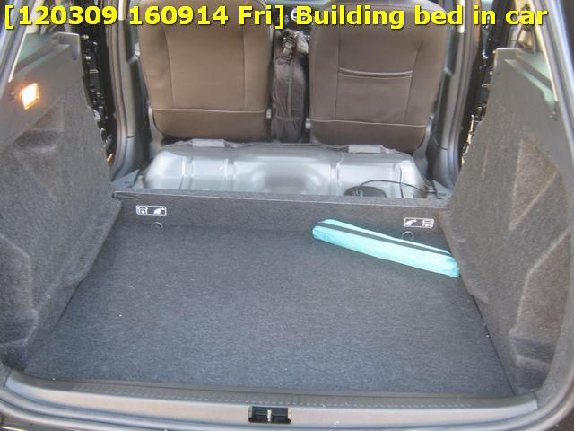

Message Jeu 20 Déc, 2012 01:58:43
Here are some photos of the car when we picked it up at CDG.

Hi Andrew !
I think that your idea to travel this way in Europe is interesting but I just don't understand the type of car you chose. :pense:
It gives a lot of drawbacks...
First, because all the items you store on the back seat and in the boot, your cargo could be dangerous.
If you break hard on the highway, for example.
For overtaking, it's difficult not to pull in front of the other car because you're not able to see anything. :ouioui:
As a conclusion, I've got just a short question: why a so tiny car for a road trip ?
For an adventurer, a Land Rover Defender 110 could be more adapted... :pense:
